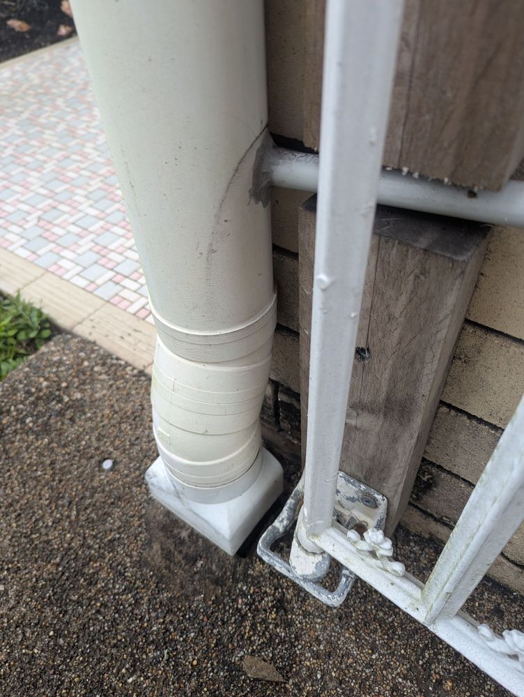

The current downpipe is round PVC, which seems to be shoved over an old rectangular metal pipe that’s still in the ground. I can poke at it with a screwdriver but can’t see inside properly. Water pools badly in heavy rain. What's the best option to rectify this?
I was considering cutting the PVC pipe and pulling out the metal pipe. Then hopefully finding something to join the cut PVC pipe back together and maybe sealing it into the ground. What should I be looking for when rejoining and sealing into the ground? Should I cut high or low?Is there a better option?

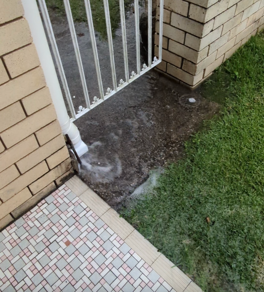

I assume a hacksaw will do the trick. We've had a bit of rain recently which exasperated the issue but even during regular rain water trickles out the side, runs off onto the title and against the house.

It appears that the former owner did not connect the downpipe outlet to the stormwater drain properly. Linking the downpipe to the stormwater drain is possible and using a Holman 100 x 80 x 90mm PVC Stormwater Downpipe Adaptor might work. However, I don't recommend puling the pipe out of the ground in order to link it to the downpipe. If the pipe is loose, it's an indicator that the storm water pipe has been compromised and water is travelling through the soil instead of the pipe.
This situation can cause underground soil erosion to occur which can compromise the cement base you have on the surface. In order to repair the drain properly the stormwater drain must be inspected to see if it is still intact, this will require the services of a plumber that also provides a pipe inspection service. Linking it blindly will cause unpredictable damage to the underground structure of the area.
Once the inspection has been carried out and an extension is all you need to connect properly the plumber can do this step for you. While the plumber is at your location it would a be a good opportunity to ask them about the blocked sections and if it's possible to re-use them and have them drain properly into the stormwater drain. This will remove all the pressure from that single drain point on your gutter system.

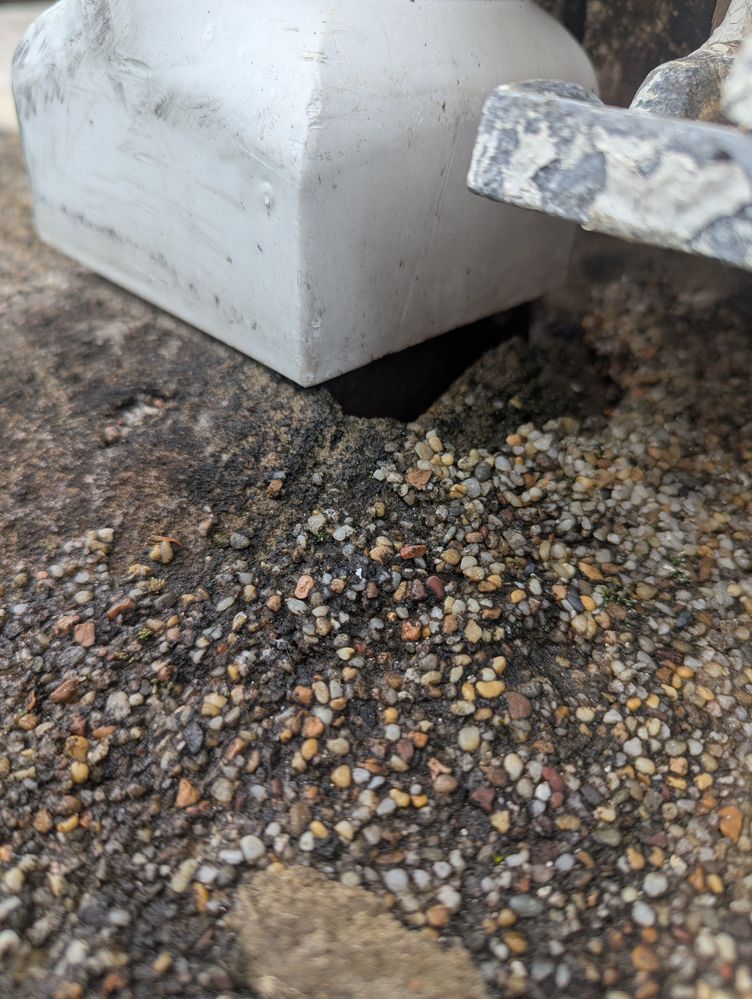

I think the mental pipe is bent or misaliged contributing to water spilling out the sides. I don't think there's a major issue with the drainage. There was a lot of rain in the day the photo was taken.
I need to take the bottom of the pipe off to get a good look. I'd like to be able to rejoin the pipe after. Is there an adaptor for this?
Once I get a better look Ill be able to confirm if I have a problem snd I can then contact someone to come fix it.

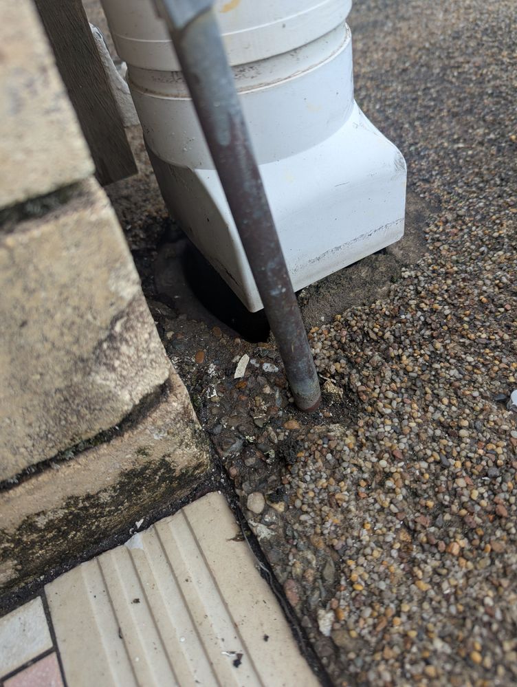

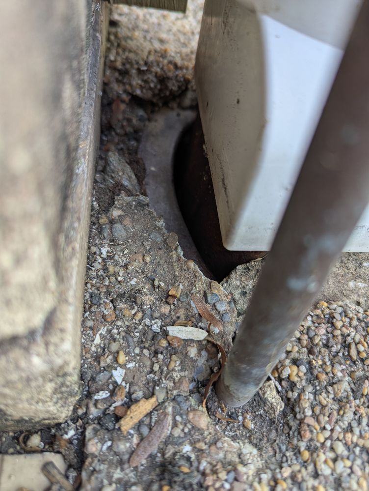

The round PVC down-pipe is 90mm. The rectangle section that goes over the metal pipe in the ground is 110mm * 86mm. I don't trust that this means that's the size of the pipe in the ground. It might not be clearly visible in the second picture but the actual drain in the ground looks round. Here's another photo. So it looks like I have a round down-pipe, that goes over an older metal down-pipe that is in a round drain. It also look like there was some cement/pebblecrete mounded up to conceal this that has since come loose in some areas.
