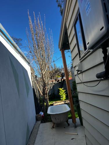

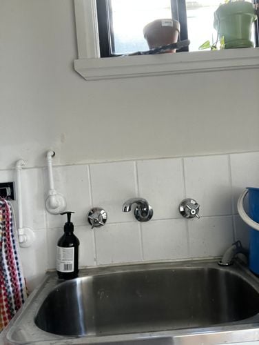

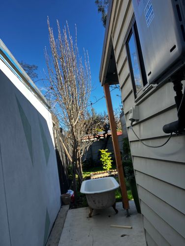

Hi all, I’ve got an outdoor bath and am about to build a little enclosure for it. It’s right outside the laundry so wondering if there’s a way to attach a 3-4m hose to the laundry tap, put it in the bath, turn it on then open a valve of some sort on the other end to fill the tub? Then when it’s full just have the hot water coming in, and opening the valve when it needs topping up.
Basically, what laundry tap attachment would work, and what do I put on the “bath end” of the hose to have control over when the tap is on or off? (Ideally would have temp control, but that would involve plumbers!)
photos show the laundry tap in question and the window/wall the hose could go thru, and the the bath in relation to the window (currently further from it than it will be).
thanks heaps!
Re: Attach braided hose to laundry tap then out to bath?
Hello @lochieg
I'm afraid your spout is not designed to accept any threaded fittings. I propose changing your spout to a Shaw & Mason Chrome Bath Spout Diverter. I propose attaching a Brasshards 20 x 15mm Brass Threaded Hex Reducing Bush LF on the diverter which will then allow you to install a Pope 12mm Universal Tap Adaptor. This will then allow you to clip on your garden hose to your bath. This allows you to choose between hot and cold and you can also turn the diverter off from the spout.
