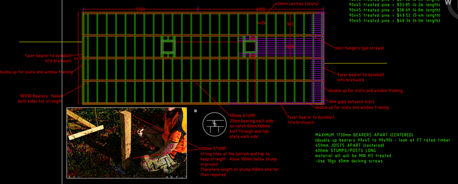

Im about to build a low lying deck off my house which I have drawn up in Autocad.
It will only be as high as the ledge from the sliding door so only 200-300mm off the ground.
I have some of which is the alfresco and pillers which is in concrete and the rest in dirt.
- Can I get away with posts in the ground with concrete (say 100mm min underneath) and 600mm long posts which are 100x100 square? And then just have spacers for the concrete area or get away with L-brackets into the concrete?
What size bolts would I use for this project? I will use joists and bearers which are normal but do I use 100X10mm into the brick work for the facer bearers? And do I use 100X10g for the bearer bolt connections also?
I will install stumps at max 1500mm centres also which havent been drawn on the picture as yet.
- Do i also need to provide drainage/black matting/rocks and that kind of thing underneath and are there standards? Where would I outlet the drainage area too if needed due the surrounds being lawn.
And any feedback on the drawing itself to change or modify would be greatly appreciated.
Orange = Bearers, Purple = slats, Green = joists
Regards Darren
