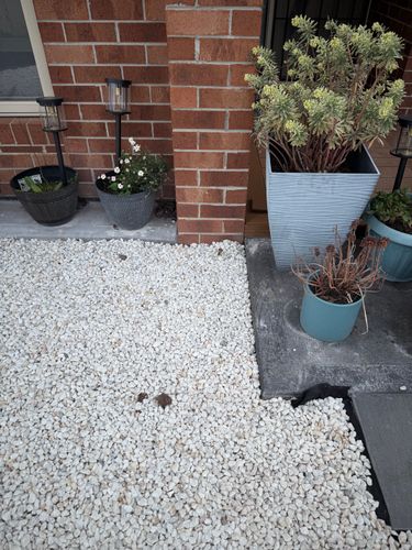

I am building a decl jn front on concrete . Very low level. But i am wondering there is as pocket of 900x 300 area on pebble infront of pillar iothers on concrete.
what should i uses on the peblles to attach my frame on pebbles.
i have thought of using crushed dust under.

It really depends on the height you have to work with. You can compact the ground, place a paver and then use pedestal feet. You could use a Tuffblock deck support on compacted ground. You could concrete a post stirrup into the soil. We also have ground screws.
All of those would work over the area; it's just a matter of the height between the ground and the bottom of your joists. If you could let me know, I can point to the most appropriate support option.
