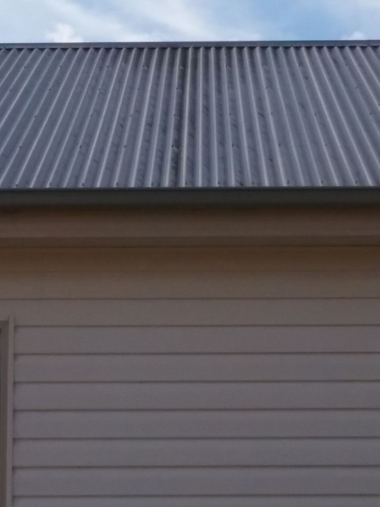

Heres a photo , can you tell me what you think the black stuff on the roof is , thanks 20250511_154823 (7).jpg
Re: How to clean colorbond roof
Hello @Cranswick
It appears to be mould and mildew along with a form of dust deposit. It does not appear to be a heavy rust infestation. In regards to the cleaner, Mitchell will be following this up with our supplier of 30 seconds. Let's wait to see what they have to say in regards to making sure that using the cleaner is safe.
