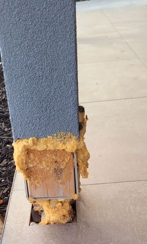

Looking for help on how I can cover the bottom part of my outdoor columns.
They are rendered.

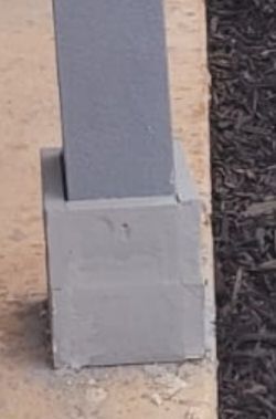

I have attached pic of what they looked like before I removed the original bottom cover ðŸ¤
It's a new build and builder is giving me a hard time anout fixing it hence the attempt to DIY.

Can you please tell us whether you just want to replicate what you had before or do you want a new look? If it's the latter, perhaps share some wider shots of the front of your house so members can see what you are working with and suggest something that might be in keeping with your home.

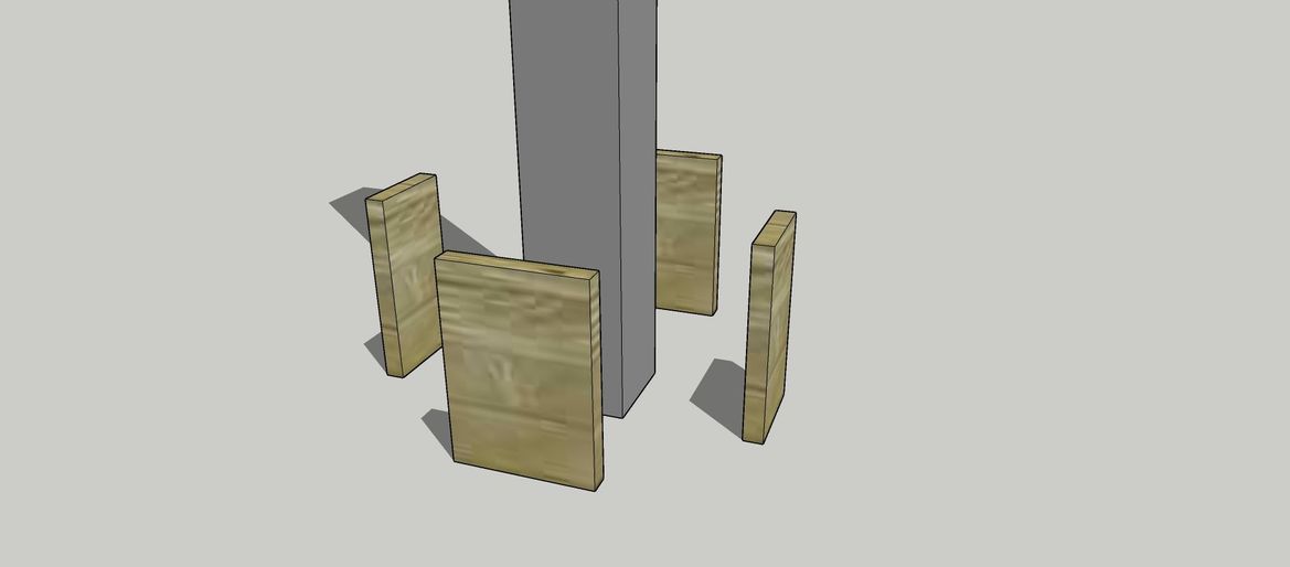

Thanks for sharing your question about covering the bottom part of your column. One method you can do to cover it is to use 140 x 19mm SpecRite Merbau Pre-Oiled Decking. You'll need four sections to create a box cover to mimic the current cover. Once the Merbau has seasoned, you can then paint it in the same colour as your post. The advantage of this is that should you need to do repairs on the post the timber box cover can easily be removed.
If you are after a flawless finish with no gaps visible, I suggest using Parfix 500g Ready To Use Multipurpose Filler. It can be sanded, painted and is weather resistant.
The other option is doing it in concrete, you'll need to build form work around the post and then fil it up with builder's concrete. The drawback of course is that should you need to access the post fittings the concrete cover will need to be smashed.

- I like @EricL 's suggestion as well, where what you had is replaced by a nicer styled timber.

Id suggest that whatever you do, leave enough space underneath the edge of the timber (say 5mm at least) so it will dry and not rot the base cover faster.
Hi @SD42
After removing the expander foam, I think the option that @EricL has suggested is a great one to consider. the other would be to basically do the same thing but with fibre cement sheeting then use a render repair kit to create the render effect which you could match the paint colour afterwards. With either cladding, I would silicone the bottom of it to prevent water entering the cavity.
