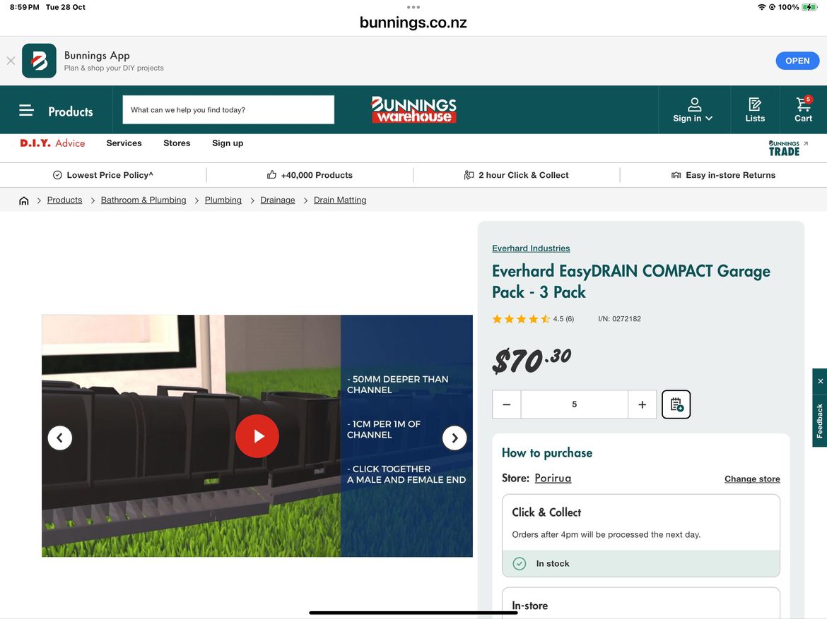

Hi,can i use the below product to create 45 degree corners or can you only get 90 degree corners. thanks IMG_0292.jpeg
Re: CHANNELL DRAIN

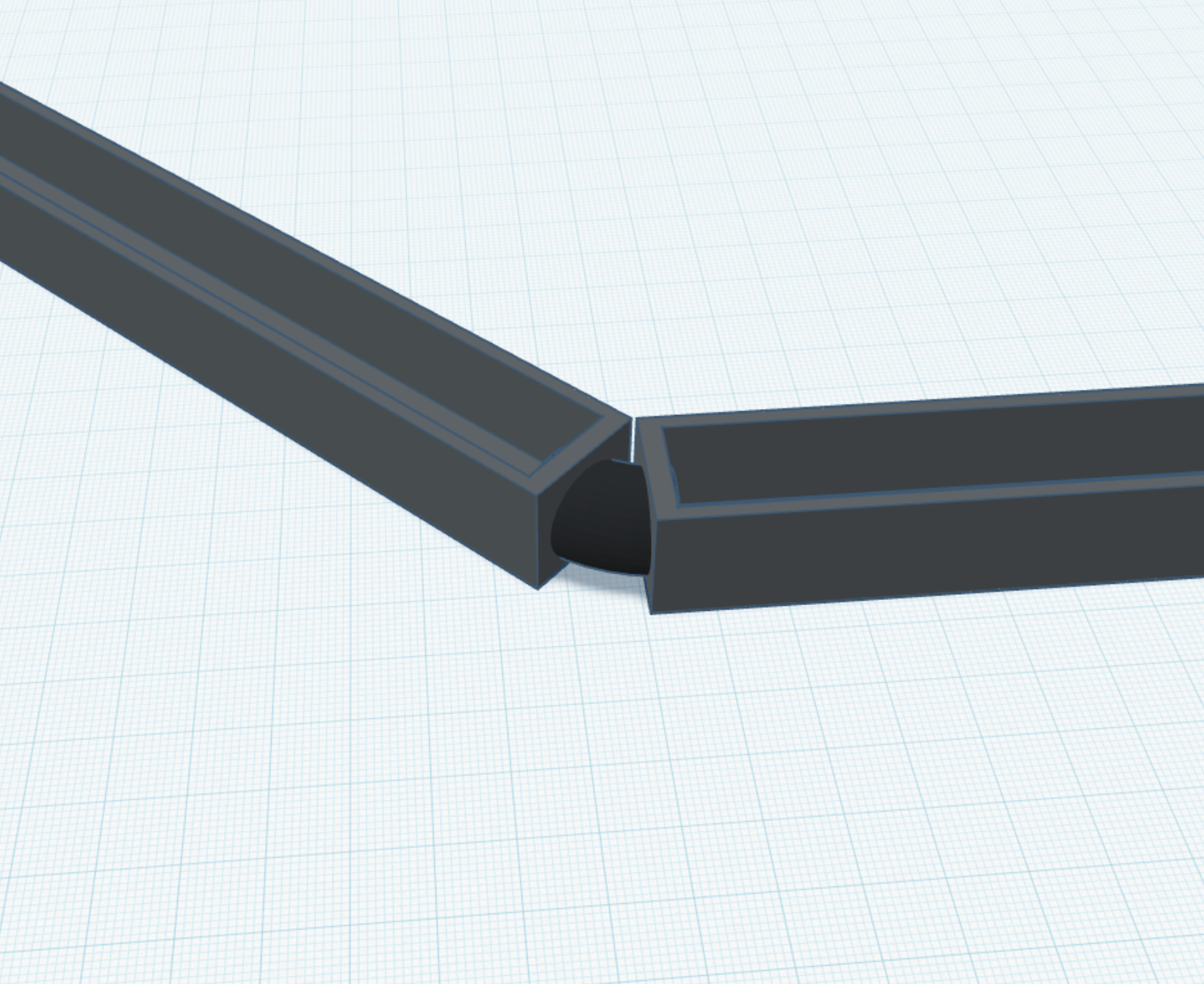

Unfortunately, there are only 90-degree corners. Would you be able to terminate each channel drain section with an endcap and run a short section of flexible drainage pipe between them, as per the rendering I've created below?
