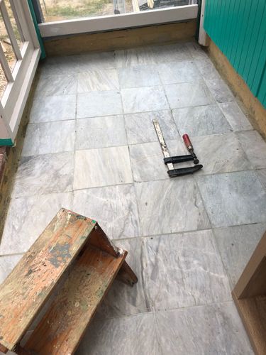

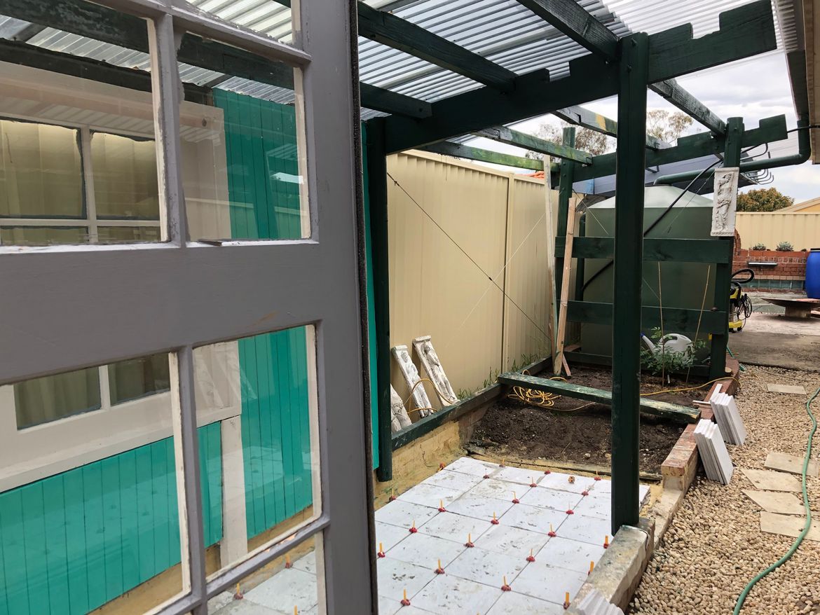

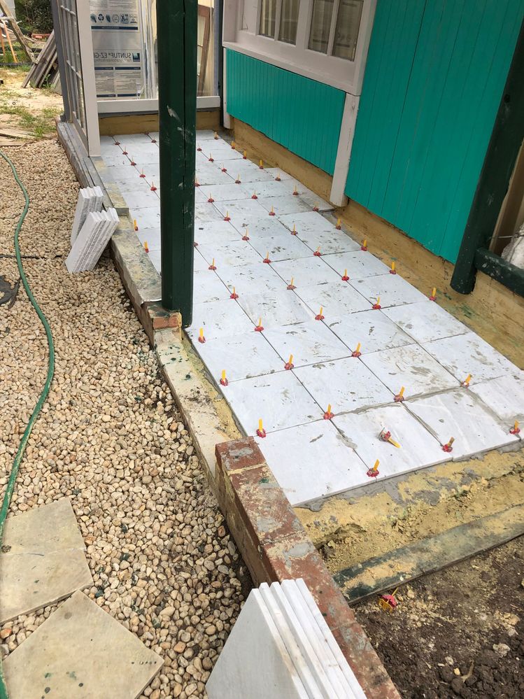

New update just added marble tiled floor. Stuff my knees again even wearing pads
Honed Marble floor
Outdoor room and end garden
These tiles are honed finish that means has minor saw marks in them. I didnt clean all the glue off as I am going to sand them. With belt and orbital sander for starters.
So I plan to get in there and sand it nice maybe even polish the marble as my skill grows. To do marble needs the wet polisher. Think variable speed angle grinder with water flowing from it for a proper stone polisher. Start price $1000 is it worth the money.
The floor was less them perfectly flat hand screeded on old knees but I did get my desired fall in the slab 1:10 approximatly incase there is ever an water spills/ roof leaks in there the water will flow out and drain away.
Hi all
A quick project update the marble floor has being belt sanded to get all the honed (saw marks ) out 5o grit paper then Orbital sander to around 500 grit wet and dry paper. This is as much polishing as we want to do a slick outdoor floor is asking for falls. Typically a purpose polishing wet grinder will go 3000 to 5000 grit for mirror finishes.
The marble was then sealed with a color enhancing Sealer to contrast the marble patterns in the stone look before and after re previous post photos.Pre polishing and sealing

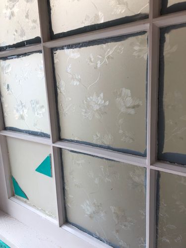

The back window (which is actually a door turned sideways) To le more light in looks at a color bond fence so to keep the light but not the view we used Stained glass look contact adhesive. Note the panel with blue triangles that ply wood saved me a trip the the glaziers.
Removable stain glass contact adhesive

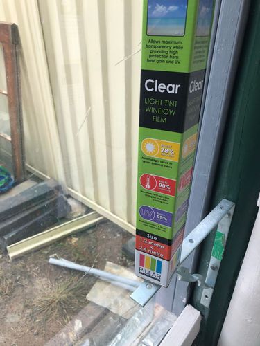

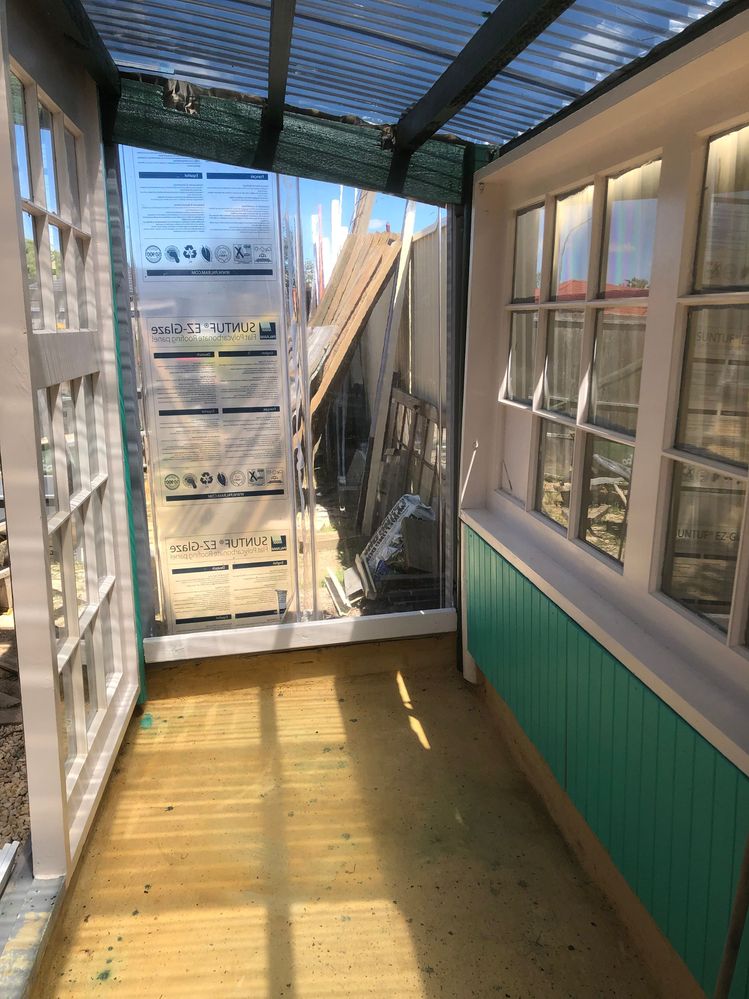

We then had western sun heat issues coming though the tall polycarbonate panels so I found at Bunnings a window film with 99%UV ,90% inferred and 28% loose in visible light. well this took a lot of the sting out of the suns rays but it is still to uncomfortable to sit in the sun (keep in mind we want the winter suns warmth). So plan c will be addition of old fashion louvers outside I am still debating what sort of block out to use on the louvers.
I am going to cut up a new sheet of 5mm thick polycarbonate into 1200 mm louvers I may have to stiffen then with glued on alumunium 10mm angle I will cross that bridge as i need to.
The photo shows the Tint fitted behind the box Yep there are a couple wrinkles that refused to come out. Its garden outdoor room i can live with that.
Tint is shown applied behind product box

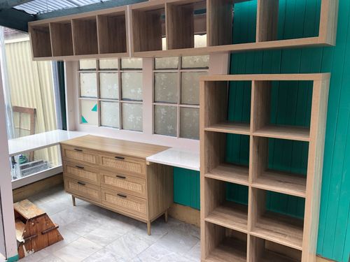

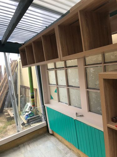

Next I assemble 2 units of Bunnings cube storage cubes 4by 1. and joined them together to make 8 by 1 and secured them to the over head rafter and rear wall. While building the cubes I used glue and 4 times the extra screws as they typically not meant to by used they way They only need to support them selves and light boxes. But I swing my whole body weight off them not dramas
8 x1 Floating cube storage

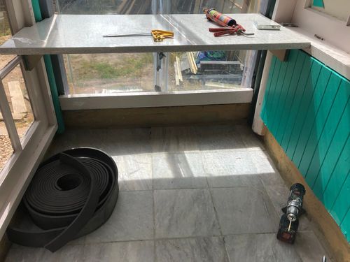

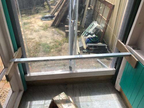

Next The desk at the end I was going to use clunky braced angles super strong but visibly intrusive for inside and out. So went for a side mounting timbers and a cross alumunium support of high no flex strength out of my scrape pile. Followed by a strip of mounting foam and the desk top with a tight fit.simple Desk frame
Bunnings laminated desk

Today built and added a flat pack added chest of draws and trimmed the legs to the same height as the desk top and window sill to increase desk top area. Then I added a desk top offcut between the set of draws and the upright 2x 4 cube storage to increase more desk space.
The Artiss 6 Chest of draws was purchased at bunnings I/n 0356366 via Market place whom posted me the flat pack $234.95
The Artiss flat pack was very well made for the price it had little details like counter sunk spaces for screw heads and the draws had a chipboard cross support under the draw base normally I have to add them myself.
The slide out draw mechanisms are a little low grade but work I sprayed them with silicon to help them move more smoothly
The cabinet tops and desk tops arnt very hardy I was gong to plastic cover them but instead I am going to try an experiment and Clear high gloss uv resistant polurethane finish them to give them a hardened top. At least if the srcatch they can be sanded lightly and re coated.
The desk tops are behind polycarbonate window out of the weather and roof sheeting which has nateral UV blocking properties so I dont expect later Gloss sun damage.
Furnature legs cut to match desk height

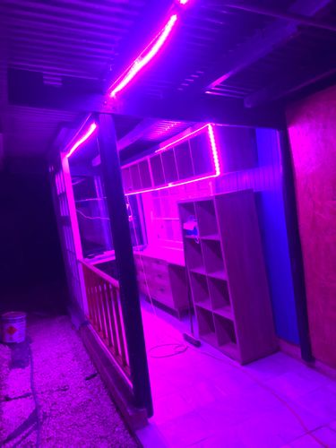

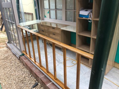

I added a timber balcony hand rail I still am not sure why I like it. I think it just helps define the space with out actually enclosing the space which is only 1.2 meters wide on the inside, a personal quirk. My experiment worked the high gloss polurethane is giving the desk and side returns a nice sheen my main goal is a hardy or sacrifical) working surface to resist scratches to desk and furniture soft laminates.
Hand rail just to define the are a bit more.
Well in the effort to make this a nice place for my wife I added some multicolored rope lights for night with some cute special effects for a bit of fun. I dont expect her working in there at night those but the leds can go white and give a decent working light. I wanted her to have a radio and good ones cost $100 plus. So Instead I took an adventurous first journey into Google Home speakers that sound pretty decent and you can ask it to put on any radio station and play just about any music you can imagine via Spofify ( a music app ) I listened to the very first LP record I ever bought as a teen ager as a test for free how incredible. The important thing about the google speaker (or Alexa if you go that way) is it is voice controlled which means a person non technical can use it once setup disabled or older people, myself.
I heard a story that crooks call out to Google and ask it to open Garage doors though closed windows, Well my doors arnt connected to that and also they are learning to recognise and strictly respond to invited user voices to stop outsiders messing with your devices. lol
Just dont ask it for a joke they are a little cring worthy.
Funky purple
Love the handrail @Jewelleryrescue; it's a lovely timber feature that compliments the rest of the build nicely.
It's great to see your project is still coming along well and looking a treat. I can't wait to see your results.
