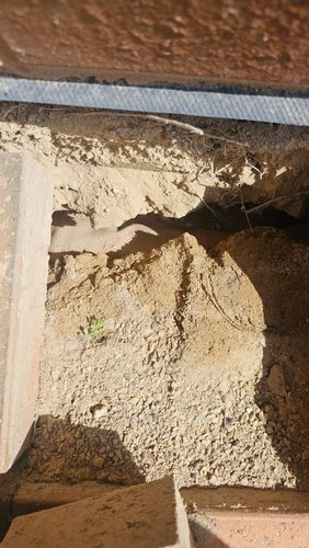

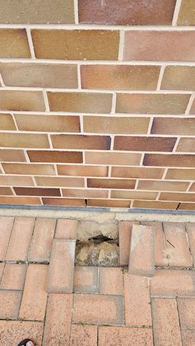

This appears to be damage caused by flowing water. You can clearly see how the sand foundation has been washed away leaving only the solid base underneath. I suggest doing a bit of an investigation and lifting the brick pavers around the house to see how far the damage has travelled. Generally speaking, it is the water run off that must be addressed first. Is water running under the pavers and causing a wash away effect?
Once the rainwater flow and drainage have been addressed, you can now address the gap between the wall and the pavers. It is difficult to tell how far the damage has travelled and how far it has eaten into the foundation of the house. I propose engaging the services of a builder and structural engineer to assess the damage. It could be minimal damage, and you caught the issue early, but it if has been going on for months or longer then it might have travelled further into the foundation of your house.
The builder and engineer will be able to give you advice about what possible steps to take in order to repair the damage.
Let me call on our experienced members @Nailbag and @AlanM52 for their recommendations.

I will remove  the brick along the sunken area  and maybe upload some more pictures, so that i maybe able to get more insightful feedback from your side as to how i can go about fixing.

It’s difficult to determine the extent of the damage but it does look substantially deep. I would be inclined to get a decent plumber in to establish the cause first before attempting any type of repair. If not water damage it may require a civil engineering company to investigate.

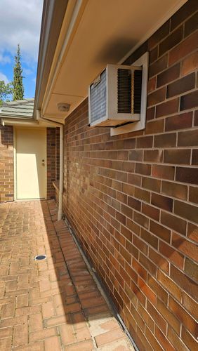

Interesting that the aircon drip pan outlet is directly above and I'm going to ask some random questions.
Have you been living there for a while.
When did you first notice those pavers.
Is that a reverse cycle unit and currently used for heating.
With the aircon running dose it drip into that hole.

We have just lived hered here for little over 1 ½ yrs. The aircon is connected to the master bedroom,but we haven't used it since living here.

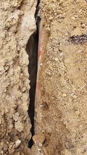

Noticed the pavers dipped when recently, i pulled out the brick and did not see any water damage. In the picture below,you can see there is quite a gap between the foundation and the red drainage flashing.

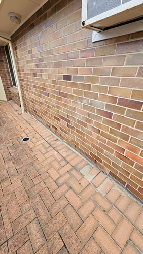

Let me tag @AlanM52 as well to make them aware of your answer. It still appears to me that water has passed through this section at one point carrying the sand away. Please continue to remove the pavers and see how far the gap travels along the side of your house.

Grab your garden hose remove any fitting and direct water into the paving grate - check the hole?
With safety in mind when using a ladder shove the hose into the downpipe - check the hole?

I removed the brick, the gap between is anywhere from 5inch to almost 15 inches.
