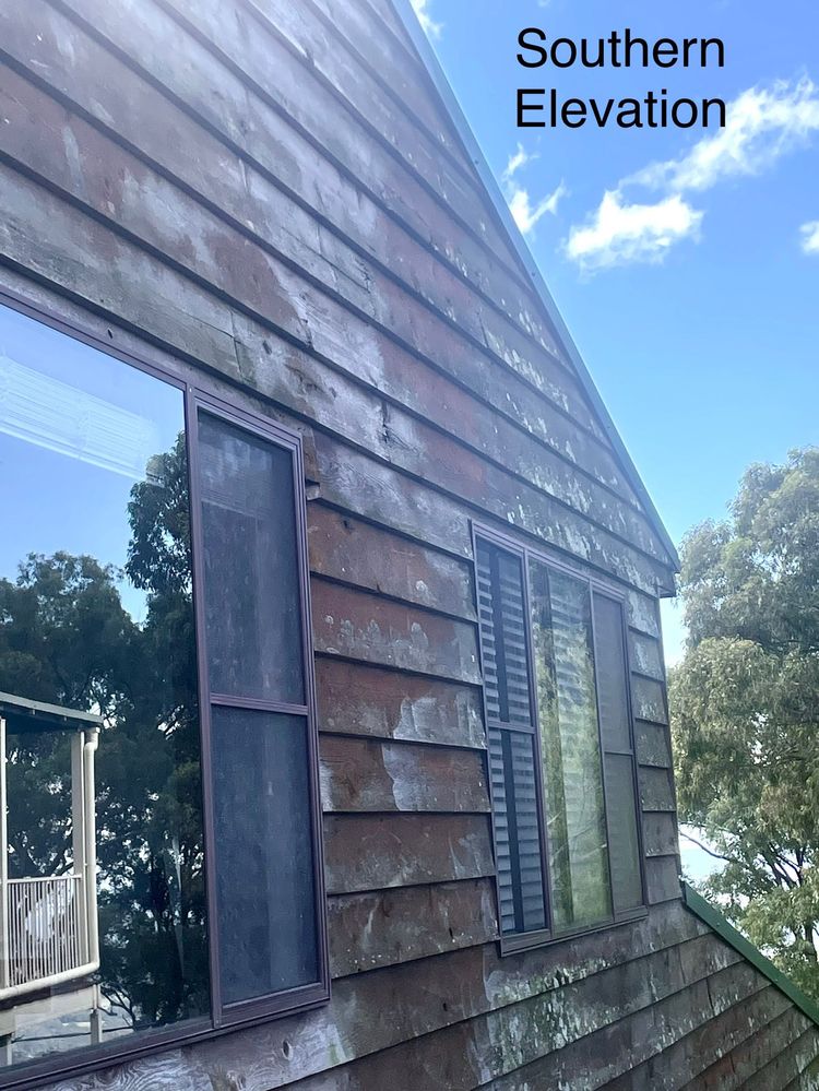

Hi all,
I've bought a house that needs some work. The existing weatherboards are rough sawn cedar stained with a semi-transparent walnut like finish. On 3 sides they need a bit of TLC due to varying levels of mould/mildew. The 4th side, the boards are cupping and rotting beyond repair. They need a full replacement, which I am getting a licensed carpenter to do.
I'd like to take the opportunity to clean and refinish the existing boards alongside the new boards to protect them for the next 4-5 years and to keep a fairly consistent look to the home's exterior.
I'm overwhelmed by the choices between oil based, water based stain and paint. A lot of people I've spoken with swear by oil based stains being the longer lasting option as it "seeps into the boards", where others say the complete opposite and that modern water based stains can be penetrative as well. I'm not the biggest fan of the block paint finish, but I have had a solid block paint finish recommended to me also as the most sure-fire way to achieve a consistent finish that hides imperfections and inconsistencies in the wear levels.

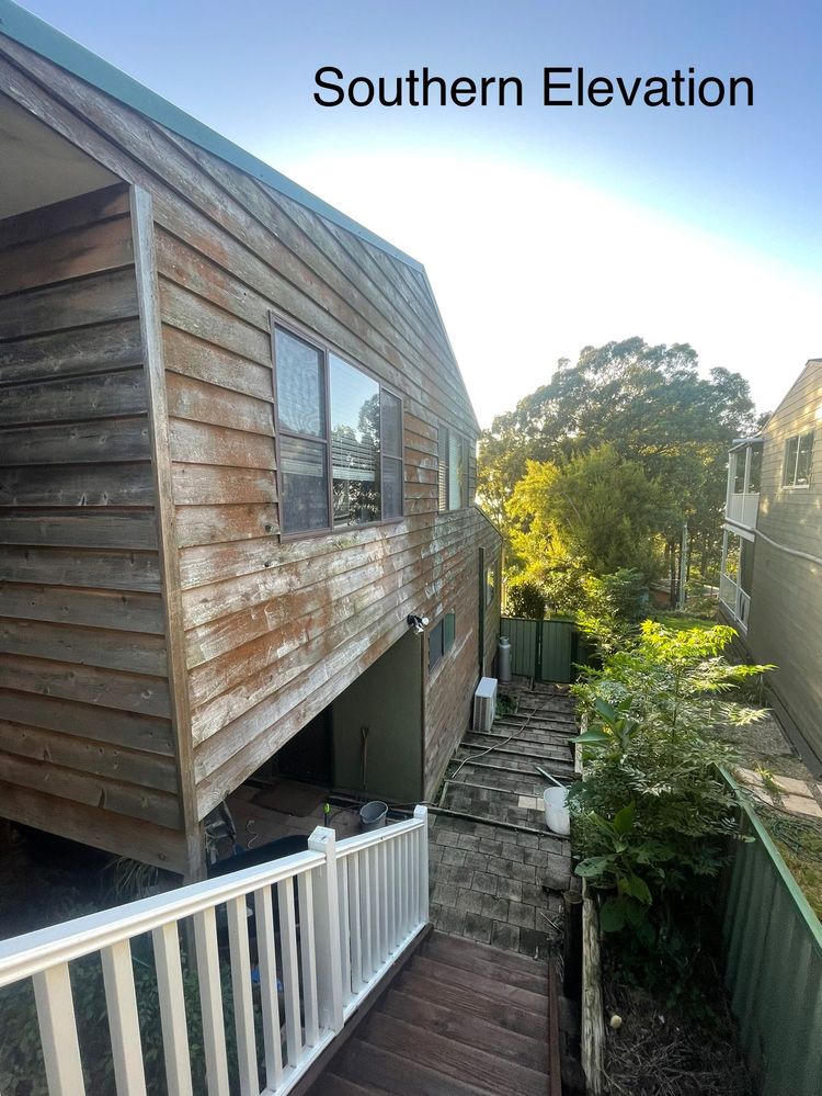

I'm also stuck on the prep work involved. The boards on the east and west side look in fairly good shape to hold up against a power wash, and the boards on the north side are being replaced with all new weatherboards so no stress there. The southern face is fairly weathered and I'm concerned about excessive splintering or other damage from a power wash. You can see evidence of an attempted power was from some time ago (the grey patches of the southern elevation)

1. based on the pictures (particularly the south elevation), how risky do you think a power wash is?
2. Is oxygen bleach effective to prep the boards for stain instead?
3. Given the state of the southern face, is a block paint really the way to go or can I get away with a semi-translucent stain?
Images attached for reference.

It would be my opinion that if you were looking to stain and oil the timber, then I would start by having it all sanded, especially the weathered sides. It appears that the boards are beyond maintenance levels of deterioration, and they need to be resurfaced. You could prep them with bleach, but that isn't going to address their raised fibres and splinters. If you don't have them sanded smooth, then you will need to keep an eye out and recoat them at regular intervals to ensure they don't start to decay.
By sanding all the walls, you'll end up with the most consistent finish, and I believe this is the best approach for the long term. Sanding now and sealing could prevent you from having to replace the other sections in the future. Powerwashing is a faster, less cost-intensive approach that will help blast off previous coatings. However, it will damage the timber further and cause more grain to raise. It's not an approach I would recommend, but I understand you are on a budget.
If the boards are sanded, you'll get away with a water-based stain. The penetrative qualities of the water-based stains are comparable to those of oil-based stains, though possibly not quite as good.

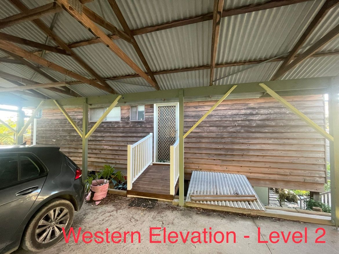

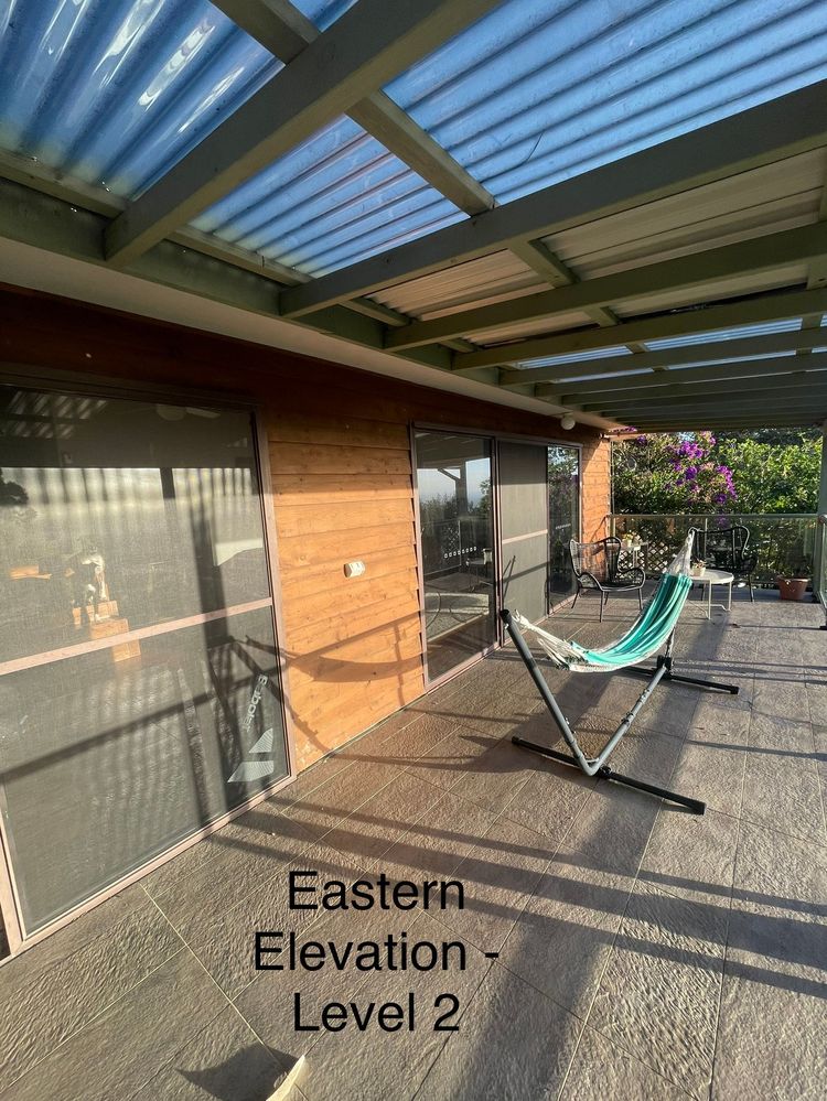

Looking at your earlier photos, it seems that the most exposed section is the Southern side. Would it be possible for you to do the sanding and staining in sections? It appears that the Eastern and Western section are not as badly exposed seeing as they have a bit of cover on them.
If you were to sand the Southern side first, I propose investing in a belt sander or an orbital sander. This will greatly reduce your sanding time and you'll be able to stain, seal or paint that much sooner.
However, if you are pressed for time and planning on using a pressure washer, I recommend testing the surface of the Southern side to make sure none of the timber has softened/rotted at the centre or the edges. Should the pressure washer hit these soft sections large chunks of your wall could be severely damaged.
Applying stain or paint over a pressure washed timber surface will work but is not ideal. Using Oxygen Bleach is not a guarantee that it will totally prep the surface. Deeply imbedded stains or sealers will impede any stains or sealers you might be planning on applying. It will thereby produce a blotchy surface finish.

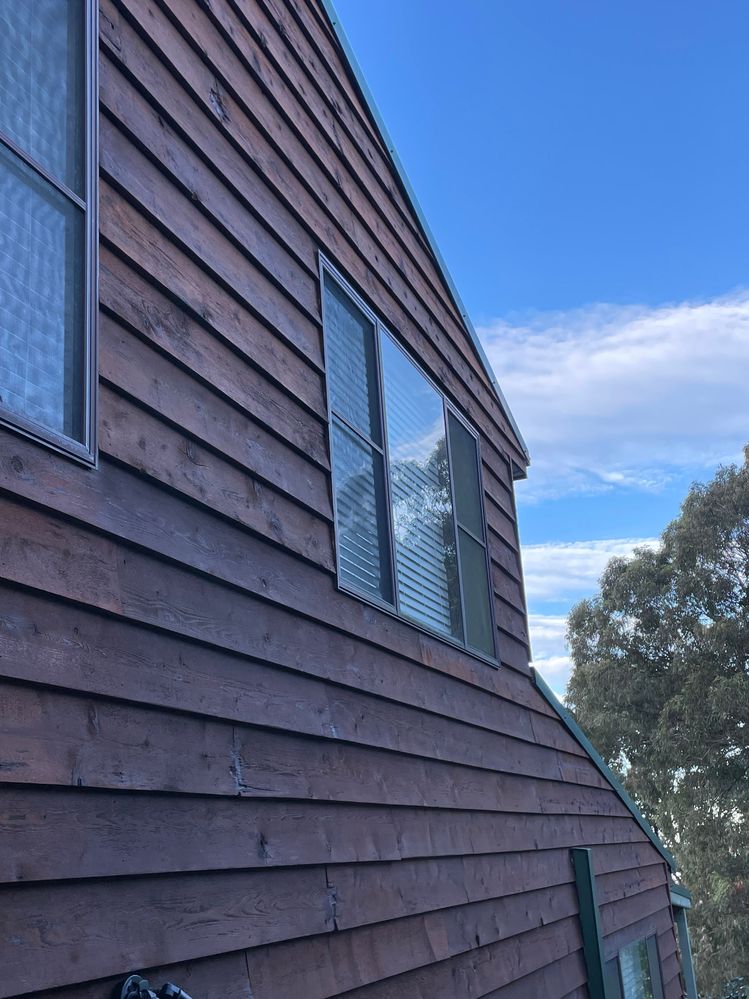

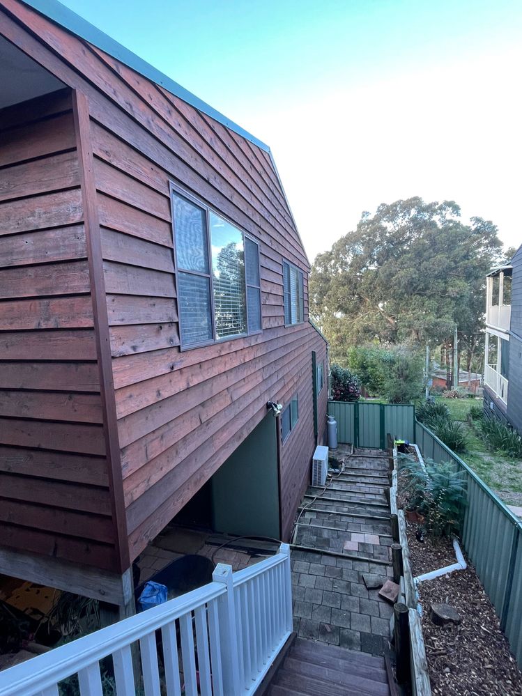

@EricL @MitchellMc @Dave-1  guys I just want to say thank you for persisting with the advice on sanding. I ended up getting a trade to sand and stain with a pigmented oil based stain, as the height made it difficult for me to manage myself.
I can see now that the pressure washer definitely would have taken chunks off given how brittle it was, and I don't think the oxygen bleach would have achieved as consistent a raw finish as sanding.
The results are far better than I was hoping. With a few timber fills, the southern side has been salvaged completely. My confidence level for saving it was probably 30% going in, so I couldn't be happier. See pictures below. The northern side of course looks great with all new stained boards, and the eastern and western sides which were protected have come up a treat with a sand and stain
