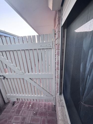

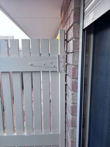

I’m looking for some advice on how to fix a sagging picket gate. The issue seems to be with the post that’s connected to the wall — the top and middle bolts  have started coming out, and the gate is now sagging and difficult to close properly.
What’s the best way to secure the post back to the wall? Should I use longer or heavier-duty screws, or is there a better anchoring method? Any recommendations on products or techniques would be a huge help.

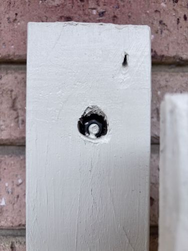

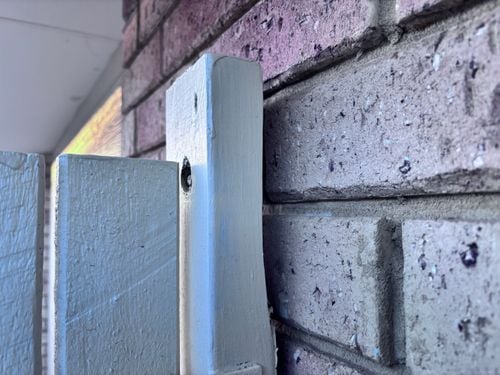

In regards to the existing bolt, can you please post a picture of it so that we can see what it looks like. We can then make recommendations on what steps to take remove it.
AKan
Re: How to fix a sagging picket gate?
 does this help?
Hello @AKan
Thank you for sharing that photo of your post. Yes, that is a hex nut, and you'll need to use a hex bit to remove it.
