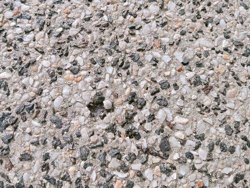

A new exposed concrete driveway got small patches. How can fix this please advise . Picture attached

I propose using Earl's 500g Concremate Expanding Cement - Bunnings Australia with a little bit of the aggregate stones spread on top.
This should disguise the surface of the patch, my best advice is to make sure that the patch does not overflow. Keep in mind that the repair dries and harden as concrete.
