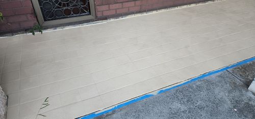

OK Progress so far.... Note immediately at the top - relatively happy so far...
So I cleaned the area - scrubbed it with CLR / Pressure washed it all....
Then I patched the cracks with builders bog and sanded it nice and smooth....
Washed it down with a hose (not pressure) to clean it up...
Then applied 2 coats of Crommelin Liquidstone Sealer - the coverage suggested was spot one - 1 tin was perfect for 2 coats of this stuff for me... Waited the recoat time of 1 hour... was bloody hot in elbourne today - but within the limits of the instructions supplied.
I cant describe the smell of this - very unusual - not nice but not offensive... Dont know how to describe it... It was just a milky type clear substance - easily put on with a roller.
Then it was time to apply the Crommelin Liquidstone Sandstone - thinking it is a close color to the tiles... What an interesting paint - its thick and has something like sand mixed through it - consistancy like a mustard - but it goes on easy with a roller.
Again the coverage was spot on - for me - it was 1.5 tins....
I can no longer see the cracks !!!

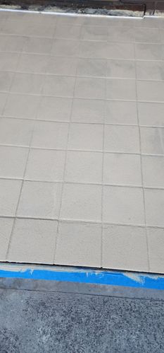

It must have been getting dark - its a lot more yellow than this.... First coat !
Very patchy... the original tiles have black grout and it really does show... But coverage was good
2 hours wait - recoat time... Second coat has improved it remarkably.... Going to wait for the morning to check - think I will apply a 3rd coat...
At least its looking so much better - and so easy to do...
You can optionally put a sealer on it - recommendation is 2 coats - and if the coverage is correct then thats just 1 tin....
Unfortunately tomorrow its likely to rain - predicting thunderstorms in melbourne - so it might be later in the week before I report back with final results...
So far - application / coverage / adherring to the tiles is all working well - will just have to wait the time to see how well it lasts.

Hello @kchambers
Thank you very much for sharing those updates. Once you remove the masking tape, I'm sure the painted tile area will look great.
Good Evening @kchambers
Looks great! Love the steps and how you are describing them. Did you by any chance take a pic of the filled in cracks before painting over them?
Id possibly suggest to remove the tap earlier then later. I have a bad habit of leaving tape and then it sticks. Cant wait to see it in the daylight!
