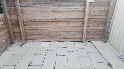

G'day all, had a feature wall in our backyard installed roughly five years ago and over the last year it's had a slow droop on its right side and appears on an angle leaning back now. Soil is mostly or entirely clay underneath the house, so everything shifts and and unfortunately so has this.

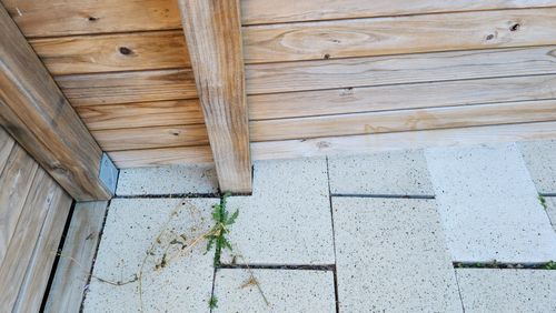

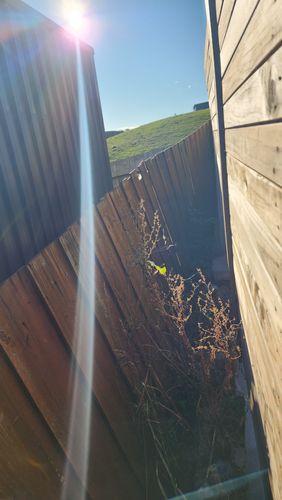

Pavers I know what to do with, but the feature wall is a bit formidable. Four mount points for the wall: two bracket mount spots on far left and right sides and the two beams in the middle are concreted into the ground. It's a bit hard to tackle from behind, can see that in the last photo it's right on the edge of the neighbours fence which has slightly shifted overtime with work they've done on their side.
Unsure how to bring it back into its original position, still learning and getting into care for the backyard so any assistance, tips or advice is very welcomed.

Good Morning @MrKayne
Looking at your photos the feature wall/fence looks level tho the pavers do not. I tried to see how far out of true the feature wall is but cant really judge. If you use a level how far out is the bubble? Or a few photos showing the amount of lean?
@EricL 's description on how to fix a leaning post makes sense to me, I always feel like I should pull out a leaning post but then you have an even bigger hole to fill/fix.

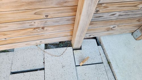

It does seem that the soil has been gradually eaten away, Even to the point of underneath your concrete path in the second last photo. Maybe pull up those last few rows before the feature wall and investigate where the sand is going. If you fix the route the soil/sand is dissapearing from and relay the pavers would the fence look level again?

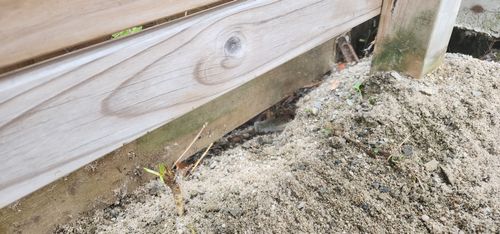

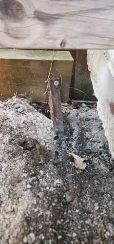

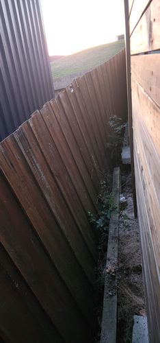

Cheers for the replies all, have been looking into it over the last few weeks since posting and figuring out a plan of attack. Have managed to clear a bush out and get back into that area, can see a metal beam that held the back wood beam in place has been pushed back over time. Fair few weeds over time and soil shifting I'd assume is the culprit as for why they've gone back. Like you said @Nailbag definitely a not to consider with the soil itself, will have a look into what you mention as well.
I had a plan to follow what @Dave-1 had suggested with lifting them all out and placing them back in, but was going to buy some sand and maybe a non-woven geotextile fabric to lay underneath the on that side of the house to help with moving into winter soon + some other stuff to try combat the weeds growing and pushing the pavers around. Have a few more photos recently I've attached. Can see that a fair bit of the sand has dripped down and will need to get a fix in for that to try contain it all again.

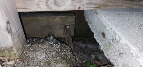

Was able to get a better view of where its all fallen down just today. Have scooped a large amount of what fell back up and have pretty much seen the fault point.
Looks like over time this back beam was pushed back and the support for it has too, leaving it to all drop down over the last 5 years.

It's good to know that you've found the fault point in the assembly.
