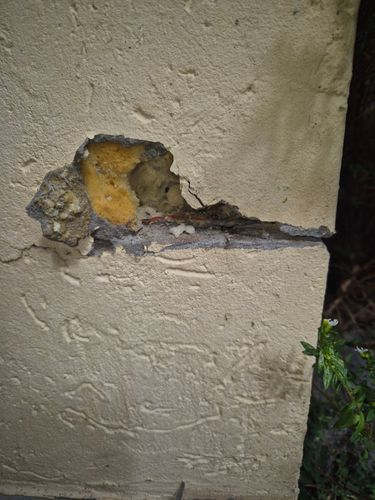

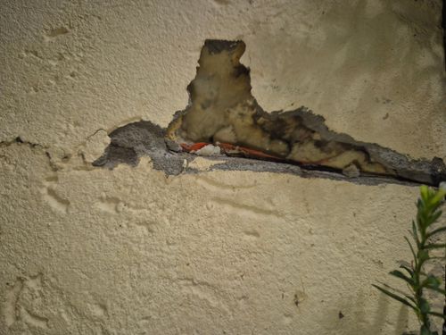

Hi been doing some house maintenance and have found maybe a meter long and 3inch high of brick missing on external part of my wall that is filled with expander foam any tips on where to go from here please.

Since the wall appears to be in good condition, I suggest using Dingo 10kg Mortar Mix to patch the damage on the wall. I propose using an old toothbrush to stipple the surface of the patch to give it the same texture as your rendered wall. Don't worry about the expanding foam in the wall, however I suggest not moving it any further. Once the mortar goes over it and cures, it should hold the expanding foam in place.
My best advice is to allow the mortar patch to fully cure before you paint over it.
