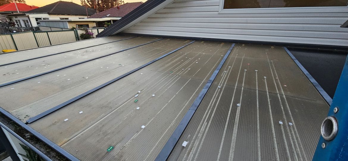

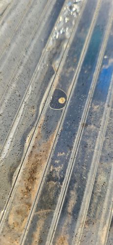

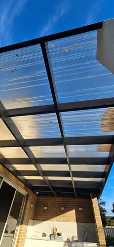

I'm hoping you get some help with holes appearing on the top side of my polycarbonate alfresco roof. Not from hail. I've tried to get a replacement under warranty without any success (installed 5 yes ago, warranty is 10yrs, very bad), and I'm want to slow down/stop the holes forming.
The holes are forming on the top side (not underside yet). I have covered some holes with Silicon and small square of perspex plastic.
Now, I'm seeing (a lot) more. I suspect it is damage from UV. The roof is still keeping the rain out and the frame is still solid. I dont want to replace the polycarbonate sheets as things are working fine (keeping rain out)
I have come up with 2 ideas and i was hoping to get anyones feedback:
- paint the top part with deluxe weather shield paint OR
- tape the entire thing with Ametalin insulation tape (sarking tape), UV resistant, handles temps up to 140C, aluminium.
I don't mind blocking the sun out under the alfresco.
I prefer the later because theres less mess and its something I can safely DIY.
Any help would be appreciated!

What a pain 😕 Looking through your photos at the moisture and that hole makes me think of hail damage, enough to either crack or put a few holes in the surface. Especially if it was super cold and a storm rolled through. I would suggest to replace the panels as being the easiest and probarly the most cost effective way to deal with the issue. Maybe wait awhile as long as it dosnt drip and save for the panels is probarly what I would do.

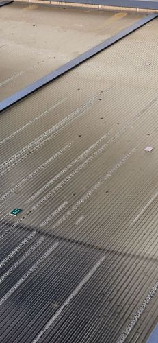

Thanks for the input, what a great community here! Here's a quick update what I did yday (pic below):
- cut some left-over Ametalin Foil UV-resistant acrylic duct tape into small squares and stuck them on. https://www.bunnings.com.au/ametalin-72mm-x-50m-reinforced-insulation-ducting-tape_p0029077
- The sheets weren't brittle when i stepped on them (thankfully)
I've used this product before to tape a crack in small shed window. It is also N facing and after 3 years, it hasnt deteriorated, so i thought this would be a good temporary option.
My gut feeling is that it's not hail causing these holes because the "darker" polycarbonate sheets are unaffected, but I could be totally wrong.
I spoke to technical support at Ametalin who make the tape. I mentioned I want to use the tape to tape the entire polycarbonate roof area. It's not intended to be used in direct sunlight all year 'round, but in theory it should work because the aluminium is naturally UV resistant. I dont mind completely blocking out the sun in this area.
@Dave-1 Yes it gets hot in the alfresco in summer, but in winter it's quite nice.
@MitchellMc Thank you! That rules our painting, I needed confirmation here, really appreciate it!
I've updated 2 options moving forward until I decide replacing, any input would be great:
OPTION 1: Tape entire affected polycarbonate sheets with Ametalin Foil Duct Tape
OPTION 2: Tape down leftover Sarking Foil, with reflective side up https://www.bunnings.com.au/ametalin-1500mm-x-30m-silversark-hd-reflective-roof-and-wall-insulation_...

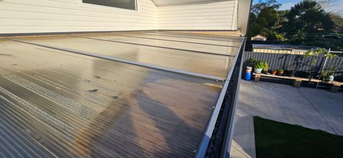

I do see your quandry 😕 The condensation really shows up and the only way I can think of removing itwould mean taking the flashing off and that would mean you are half way towards switching out the sheets. Cost wise maybe replace a few at a time as you can afford it?
