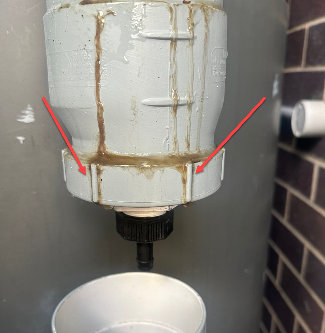

Hello everyone,
We've just moved into a new home that has a newly installed rain water tank. Not being very clued up on these, last week I tried to open the black nosel on the first flow diverter, thinking it was where the garden hose attaches and when dripps started coming out I tightly closed it, having thought I'd messed up. We now realise that it's supposed to drip! What's happened now is that no water gets through and it's leaking from the connecting pipe which is slimy and smells bad.
I've tried losening the black nosel but nothing happens. Is it all backed up with gunk I wonder? 🤔. I'd love to know what to do here to solve the issue as rain water feeds into the laundry and washing machine. If we need a professional, who do you even call?
Humble thanks from a total outdoors newbie!

What you are looking at is called a first-flush diverter. It is a device fitted to a rainwater tank system that improves water quality by preventing the initial, most contaminated runoff from entering the tank. When it first rains, debris such as dust, leaves, and bird droppings is washed off the roof; the diverter captures this “first flush” of dirty water in a separate chamber. Once that chamber fills, cleaner rainwater is automatically directed into the tank, while the captured water slowly drains away. This simple system helps keep the tank water cleaner and reduces maintenance needs.
With the dripping head being blocked, I'd say it is backed up and not operating as it should.
To fix this, you'll want to unscrew this cap here -
If it is on tight and you can't unscrew it by hand, you can use a pipe wrench to rotate it off. If you wrap the cap in a rag before slipping the pipe wrench in place, it will protect the cap from damage that could be caused by the metal of the pipe wrench.
Now, there might be a float inside the diverter that you wouldn't want to lose down the outlet pipe, so you might want to put a bucket under the pipe once the cap is off to catch it. If there isn't one, there's no issue, but it's best to be prepared in case.
Once the pipe has been cleared, clean everything up, insert the float if one falls out, then screw the cap back into place. Once it is back in place, you'll want to adjust the black nozzle so that it slowly drips. You don't want water to be streaming out, but you don't want it to be completely sealed as the pipe needs to fill with water so the water can flow over the top and into the tank.
After a good downpour, it is worth repeating this process as any leaves or sediment that washes off the roof will be captured in this pipe.
Once you've done it once, you will understand the process and you can repeat as required. This will help keep the water in your tank from being contaminated with sediment and other solid matter.
