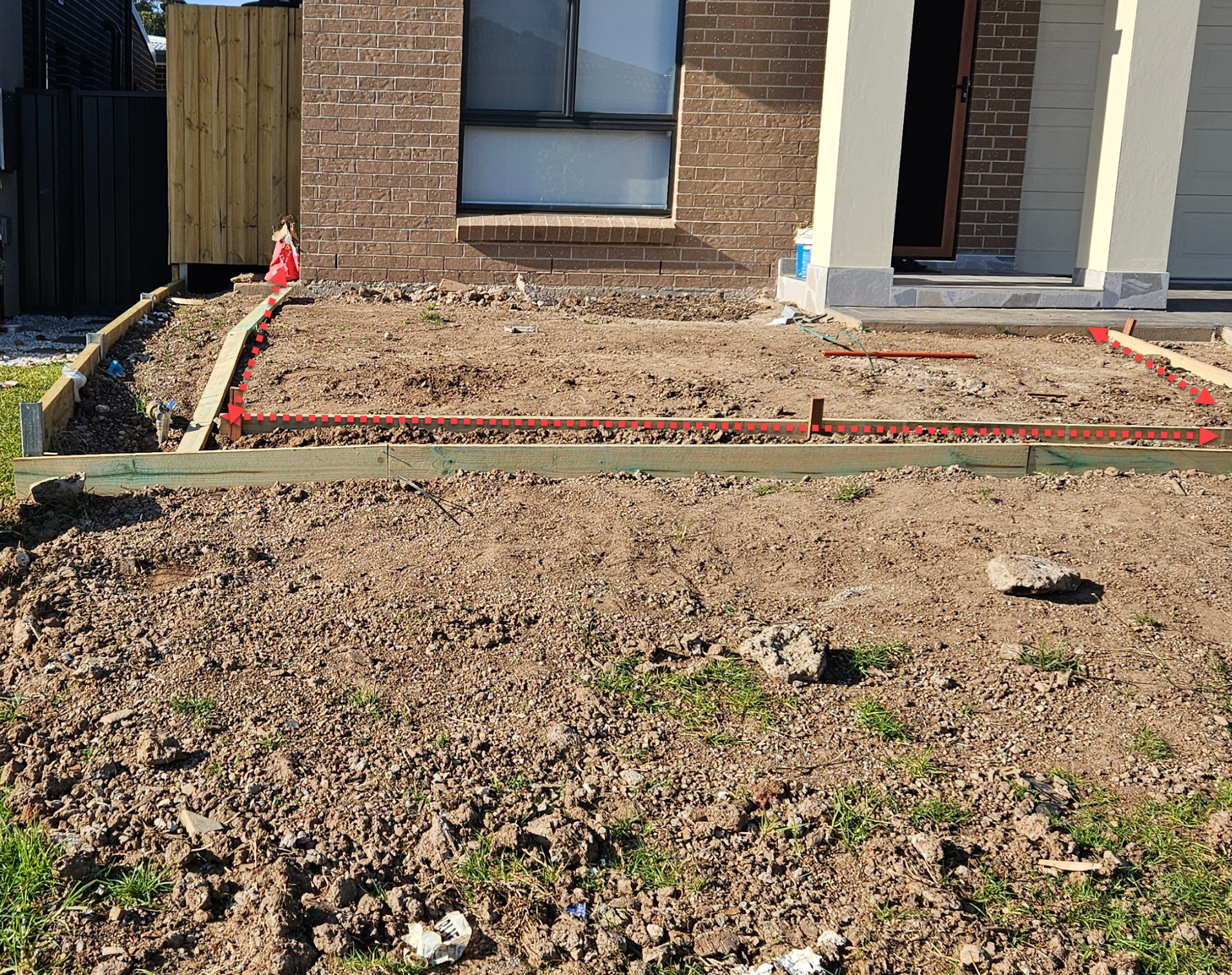

what needs to be done for my front yard to level it and make it look good
Hi @Houseproject07,
Thank you for your question about landscaping your front yard.
It looks like there might be some formwork set up. Is there a concrete path or pad being installed, or is this just leftover materials from construction?
If you were looking to level the front yard, you would need to make a delineation somewhere and add a retaining wall. If there is concrete going in, then it should be somewhere at least 300mm or so away from this concrete to enable you to install retaining posts. It looks like there is some kind of barrier already there. Was this installed as a retaining structure already?
If you're just looking for guidance on preparing the ground for turf, then you would start by excavating the top 100mm or so of soil and removing any large stones or construction waste. This is achievable with a shovel and wheelbarrow, but the simplest way to do this is to get a skid steer in to do a site cut.
Once this top layer of soil and any hard rubbish has been cleaned up, add a layer around 100mm thick of top dress, which can be purchased in bulk bags through your local store's Special Orders desk. It can be spread with a wheelbarrow and shovel and then smoothed and levelled with a Top Soil Spreader.
You can then follow How To Lay Turf for a guide on installing turf on your prepared area.
Once turf is in place and any further work has been done, you might like to consider adding some garden beds or decorative elements. Check out Top 10 most popular front yard projects and 10 ways to improve your home’s street appeal for some inspiration.

Good Afternoon @Houseproject07
@JacobZ has pointed out a few ideas that would get you going.
Some other things to consider, plants, shrubs and trees. Easiest way I know is to take a stroll through Bunnings and have a look at what types you like and then take note of how big each grows (height and width) Then go home and sketch up your yard anbd what you want in it. Even if its just level grass then some flowers or succulents on the edges might be nice.
The stormwater pipe you have from your photo I would check to see if its still in its original form. I have seen a bunch of stormater pipes with gutters like yours be squashed from deliveries and builders ot really caring. It would be a shame to fix the yard and then find out the pipe is compressed. A note of caution for checking before you dig especially on the footpath. Double caution for sure.
I have made these garden beds and on left side I have made retaining wall.from here do I need retaining wall in front or just level bit more council area and it should loon good
Hi @Houseproject07,
I don't think you really need a retaining wall based on what I'm seeing. A gradually sloped front yard will still look good.
I'd just follow the steps I mentioned about adding top dress and then laying turf.
