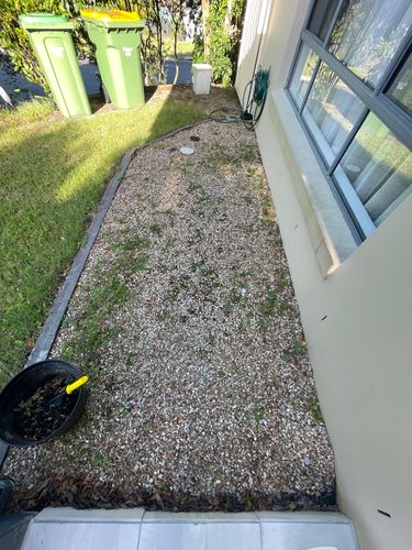

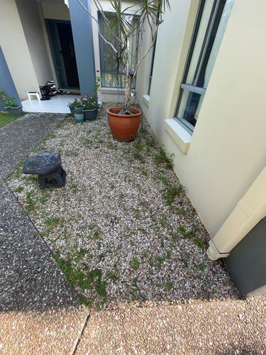

I would like to get rid of these pebbles from these two areas of front of the house. They are requiring constant care and as you can see in the pictures the growth of unwanted greenery.
what would be the best options here.
my approach was to use pavers on both sides of the front, leveling to the existing pavement.
If this is the good option, please suggest me the right way to do it. I believe we have to do something to avoid these unwanted greenery to grow again.
thanks

For a much lower cost option, you could just put weed mat underneath. This would stop the weeds from coming through.

It's great you've already received a helpful reply from @KirkyR. Adding weed matting under the pebbles is great insurance to avoid weeds growing up from the soil beneath. Another option to consider is spraying a path weeder over the area. It will kill the existing weeds and prevent them from coming back up for twelve months. Spraying the area once a year would likely be an easy option for preventing weeds.
Adding paving to these areas is certainly an option. Remember, though, that weeds also grow between pavers, so there's still going to be a certain amount of maintenance, but likely less than the pebbles. Here's a helpful step-by-step guide on How to lay paving for a path. It's the same process for a paved area. Also, check out these Paving ideas for outdoor entertaining areas for inspiration.
As these areas have angled sides to them, you'll need to cut the paving to suit. There's going to be a bit of work with an angle grinder and diamond blade to cut the paving accordingly. Please remember your PPE when cutting masonry, including gloves, a face mask, and safety glasses.

@KirkyR and @MitchellMc  Appreciate your recommendations.
To be honest, I would like bring some change on the front side of my house. Let's say like this:
there are weedmats underneath but seems like they are there from long time. We are in this house for 3 years now and they must have been there before that. They look like torn apart already.
I have to get out all these pebbles anyway. What I am planning is: to get out all the pebbles and put a new weedmat and put all the necessary materials for the Pave and lay paves.
@MitchellMc I know it will involve some work from angular grinder but I have to learn to do it anyway for my tiling purpose. I will make sure that I PPE standards.
