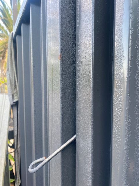

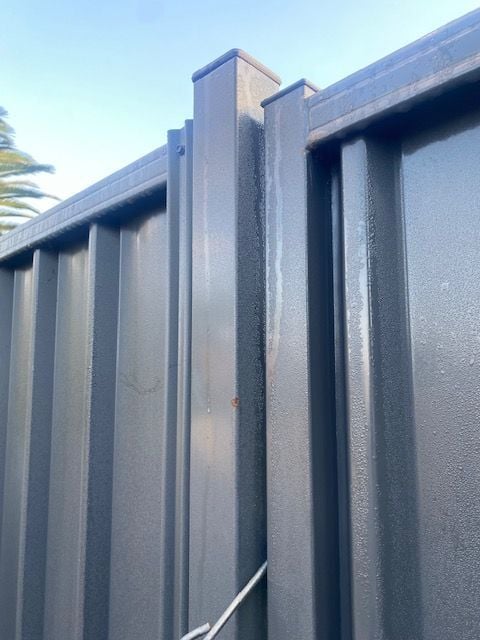

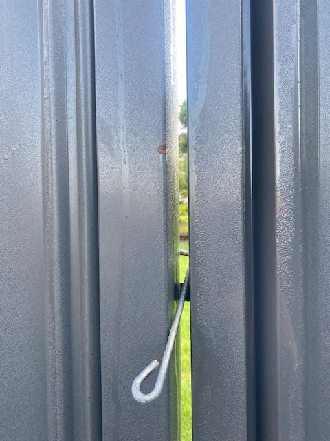

I have a colourbond gate that helps my children move from my property into my ex-partners property (our properties back onto each other). I would like to have a lock on my side. I would like to try and install it myself. What type of lock and how can I install it? The fence and the gate don't line up, thanks

You could probably install a Pinnacle 150 x 12mm Matte Black Double Eye Padbolt at the top of the gate. The bolt section can be attached partially on the vertical upright and then onto the horizontal top rail. A hold can be drill in the post to accept the padbolt when secured. Metal screws can be used to install the padbolt.
Sliding the padbolt across will prevent the children accessing the gate and a padlock can be added for further security.
