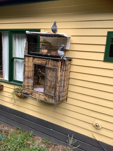

I bought a cheap (now I have figured out why) bird box to house our two pet pigeons in. It is made of chipboard which means it won’t be weather resistant. Current cage is under the eaves but only ok if the rain is considerate enough to come straight down and not at an angle. Being metal it’s no problem but the one I bought is a much better option for overnight.
Considering painting both inside and outside with a recommended stain stop waterproof primer, wondering if that will be sufficient because there is no way these pigeons are living inside. Both pigeons have been hand reared and have no concept of personal boundaries.
ideas please?
