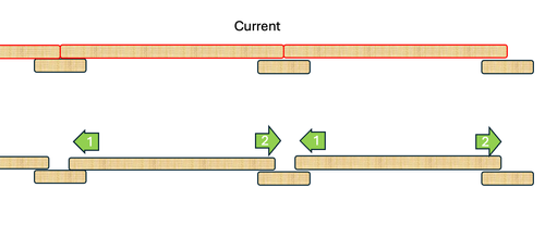

To remove the bottom row only, you will need a reciprocating saw, which you can borrow, hire or buy. If you know a plumber or builder, they will have one for sure. If not and if you're not likely to use it again compare hire cost vs buying something like this corded model. If you're already in a battery tool system check out their models. Just be aware you will chew through the battery charge. These saws are also ideal to prune tree branches etc. which is also the blade to use for this application as its course teeth won't gum up with damp sawdust and dirt. But will dull it.
  • Dig the soil away from the bottom row.
  • Then drill near the top and near each end of the sleepers with a 25mm spade bit.
  • Insert the blade around half depth so your not digging to much in to the soil, and make the vertical cuts. The soil behind will be very compacted so it won't collapse when the sleeper falls away.
  • Dig behind each remaining offcuts behind the vertical supports to remove them.
  • Replace with new sleepers shorter than original. This allows you to insert one end then push in and slide along the other end as per image.
  • Drill an 8mm pilot hole through the vertical sleepers and drive a suitably length (depends on your sleeper thickness) batten/bugel screws to secure the new sleepers into place.
