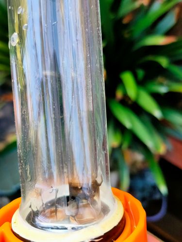

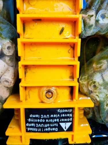

Just an update, I think the UV bulb has blown up and its its only on a couple of usage. I have been told by the shop, since this is a replaceable item, its not covered under warranty and need to buy a new globe. Very upset about this.
  the LED light also is playing up with on and off.

Not so happy new year for your pond.  How  are you sure it is blown as  they not like  regular bulbs you can see them on except via a viewing port.
I believe you though.  Keep in mind the fault maybe the terminals to the globe that means a  genuine warranty claim
I certainly  would expect good  UV Bulbs from a decent UK company Bladgon.    But failures can occur sadly and I would  also be as  disappointed like yourself.  As  far as warranty goes  they state 3 year warranty they dont openly show warrantee document.  I would say in regards to consumables they should  be expected to run for more than a month and if it fails too soon I think the company blagdons in UK would spare a $21 bulb just to preserve there reputation.
Also you remember  you asked  us about an led light  flickering at you on purchase maybe it was  the viewing port to the UV light you where seeing .That  means it was faulty from day one which  means they should replace the bulb for free.
I would also  definatly contact blagldon in the UK and see if they are willing to have a poor reputation over a 21$ part.  Get your reciept ready.

Yes, I believe the UV light stop working as I cant see any light on from the cover.
The retailer said if its bulb burnt out, need to buy a new one, unless its a faulty unit. That's why I bought it from a shop, and I will bring it to check tomorrow.
Meanwhile I will email the  Bradgon  uk about the issue.

Show the old bulb  not working bulb in the unit and try a new bulb in unit if new bulb not working then is  the unit at fault and a  warranty claim 100%.

My Main concern is the unit is making  good contact with the  UV tube re the on off flickering is now suggesting a bad contact or other fault that came with unit from day one. Install a new bulb and look at that UV port.  And further proof is future alge erradication is not working ,  The existing  string alge needs to be maunually removed and you cleaned you filter and that needed to be done so all is good.  The benificial bacteria will have being reduced from foams etc  but your pond is big enough to have bacteria growing on the edges to support life.
You  should see faint blue light from UV viewing window with filter foams and cartrigde removed

If your pond  grew alge it is  proof  the UV wasnt working at all during all that time.  So ask  shop guy why a 1500 litre pond can grow  alge if UV working. Answer is if everything flowing right and UV on  it could not.  I read the blagdon 6000 3year warranty  Lamp  no warranty but you said unit flickering from day 1 so that is different called DEAD ON ARRIVAL it should be working 100% Plus CLEARWATER  GUARANTEE states that for 1 year after purchse your water will be clear  to a depth of 1 meter With T&Cs  your alge fails that test.
Well they said they will replace bulb so thats a start now we just need to make sure that flickering  UV isnt happening like when you first bought it.

As for the uv light, the shop has obtained a replacement globe and is a one off only. The retailer said usually, if theres a power outage, this may occur. So usually no warranty.
