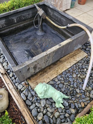

I emptied my water feature for cleaning and would like to redo the waterproof membrane.  I believe the structure is glass reinforced concrete.   Should I paint over it with a primer and Crommelin pond sealer or use a pond liner.  A pictures of the base is attached.  The outside needs repainting as well.  The water feature is over 10 years old.

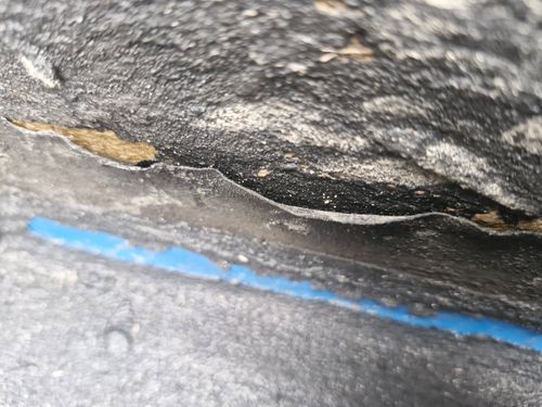

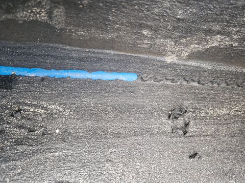

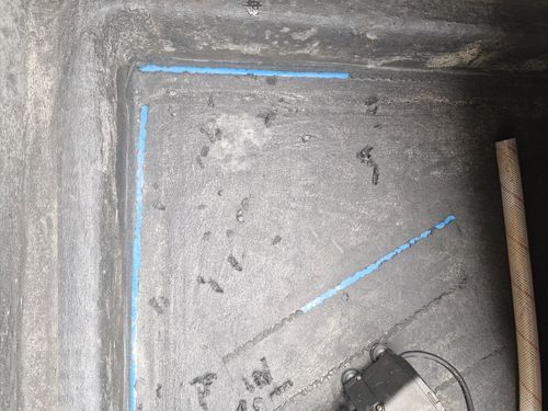

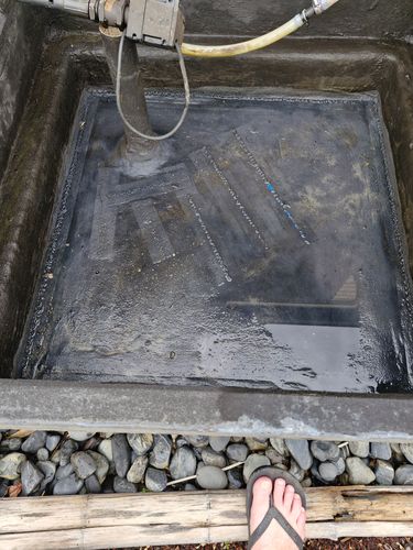

I would like some more advice please.  Removing some of the blistered  membrane  has revealed a blue plastic type lining under the current membrane on the water feature base which appears to be installed using an adhesive tape.  I have attached photos.
The blistering is around the edges and a couple of lines in the middle.
Can a tape like Gorilla patch and seal waterproof tape be used over the blistered areas or can the Crommelin primer and pond sealer be used directly.  I want to avoid removing what is currently there if possible.  As I mentioned the water feature wasn't leaking when emptied.  It was taken apart to be cleaned.  Any advice would be appreciated.  I have also included a picture of the actual water feature found online.

Hi @Cathy001,
What you've uncovered is waterproofing tape like this Crommelin 5m Waterproofing Tape.
It is used as a strengthening material in waterproofing systems where there are junctions. It bridges the gap between the horizontal surface and the vertical surface before a membrane is applied over the top.
As it is not well adhered to the substrate, you should remove it and replace it with new waterproofing tape like the Cromellin one I have linked to above.
