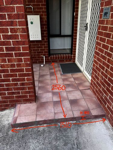

I'm planning to replace my current very dated concrete/tile front porch (images below) with timber, and looking for some advice, so hoping someone here might be able to help.
I've read lots of articles on BW about building decks over concrete - however, most of them have enough clearance to build directly on the concrete, using either plastic footings or angle brackets. In our case, it looks like the porch was originally built by pouring a raised section of the concrete slab (approx 80 mm high) and then sticking tiles directly onto it, and painting the sides. Therefore in order to get enough clearance to put joists in, I'm assuming the current concrete footing will need to be removed, most likely with a jack hammer.
The main questions I have:
1 - Is there a way to remove just the tiles and affix decking boards using the concrete as a footing? (I'm guessing this is very unlikely)
2 - If the concrete does need to come out, do I just need to take off the existing 80mm, or should I take out more to leave additional clearance? (the smallest joist dimensions I have seen in the guides are 70 x 35, so 80 mm wouldn't leave enough clearance for joists, plus decking boards)
3 - Is there a way to remove the concrete that will leave it flat/even enough to use as a base for the joists, without damaging the rest of the surrounding concrete?
(3b - If not, would I need to use something like Lanko 173 Floor Leveller to get an even surface to lay joists on, and will that be suitable for affixing into e.g. with Dynabolts etc? Or will the jackhammered surface need to be levelled off by grinding with a diamond concrete grinding disc?)
In terms of my DIY ability, I'd probably rate myself as intermediate - I've done plenty of small improvements over several years, including building a deck in the backyard, and have previously removed a concrete path in the backyard using a jackhammer.
A- Id say not worth the effort as the tiles plus grout will be maybe 10mm thick.
A- That 80mm isnt a lot of space to build a deck especially with the door just above. (After going through just now looking projects id have to say maybe but with limitations)
A- I suspect you could remove that patio slab but still may not get where you want to be. I would be hoping that they have laid that footing straight on the concrete path, Thats why I want to know what is behind that timber looking strip?
A- You could use brackets to support the joists so this wouldnt be necessary.

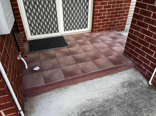

1 - On the second pic is that a piece of timber across the width? Any chance you could remove it to see whats behind it? As in a concrete slab or fill?

Hi @Dave-1,
Thanks for the reply and working through my questions - very helpful! To answer yours:
1 - Unfortunately that isn’t a timber board running along the front that can be removed, it is an exposed edge of the concrete footing that has been painted reddish/brown
2 - That’s a nice suggestion, it could potentially be a solution to my question 1 above but using an engineered click in place option rather than timber. I had a look and those units have a listed thickness of 2 cm, so if I removed the existing tiles that would free up about 10 mm, so they might just fit on the existing concrete without any need to remove any of it.
Update - I spoke to a guy in Kennards about jackhammer rental and showed him pic 1 from the original post. He recommended to consult a concreter to make sure that any jack hammering would not affect the adjacent brickwork. So I’ll be following up on that to get a professional opinion about whether it’s even possible to get rid of the concrete without compromising any of the walls on the front of my house.
Cheers, Tom

Hi @tmurrayrust
That electrical conduit going into the concrete would be the most breakable thing.
To my construction eyes I am seeing a house built of bricks and the slabs and porch added last flush to the brick wall post build and should ealily come away from the wall. I would have used steel reo pins into the house foundation to support slabs, But if you discover they installed angle grinder will cut them with ease.
Only get a medium to light jack hammer you can handle the weight of as you need control is the key to an easy job.
Aslo invest in a rotary hammer drill for fine work as it can be used as a cement chisel. can easy go into 200mm concrete. with a chisel bit/
Hi Jewelleryrescue,
Thanks for the follow up - the conduit is for an old Telstra cable, and we dont have a landline any more, so if it breaks then no major harm done.
Yes agree its likely the front porch was built after the brick walls - though what I can't tell is whether the driveway was poured first, and the porch on top (in which case it should leave a relatively even surface when jack hammered out) or if the whole thing was poured in the one go. If the latter then it may be a bit rougher and might need fixing up a bit before installing any joists. Either way, it won't be 100% clear until I get stuck into it...
Yes the plan is to get a medium weight JH, and fortunately I already have a Makita rotary hammer which should allow for more control when removing both the tile layer and any concrete close to the brickwork.
Thanks again for the input!

Hi @tmurrayrust
I hear you re old telstra land line. I would preserve that telstra pipe just in case as Future fibre optics has to physically get to your house one day possibly. and they might just be using same conduit. Other wise they will have to dig whole new line in . But 5G is supposed to be coming so 50/50 on its continued use.
I hear you re drive and step poured possibly at the same time I would be highly surprised if they did. But you can rough break up the concrete deeper than required and pour a nice leveling layer for new work to sit on
as you said not a huge area.
