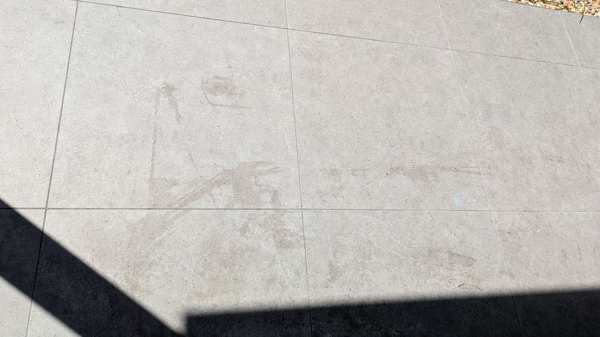

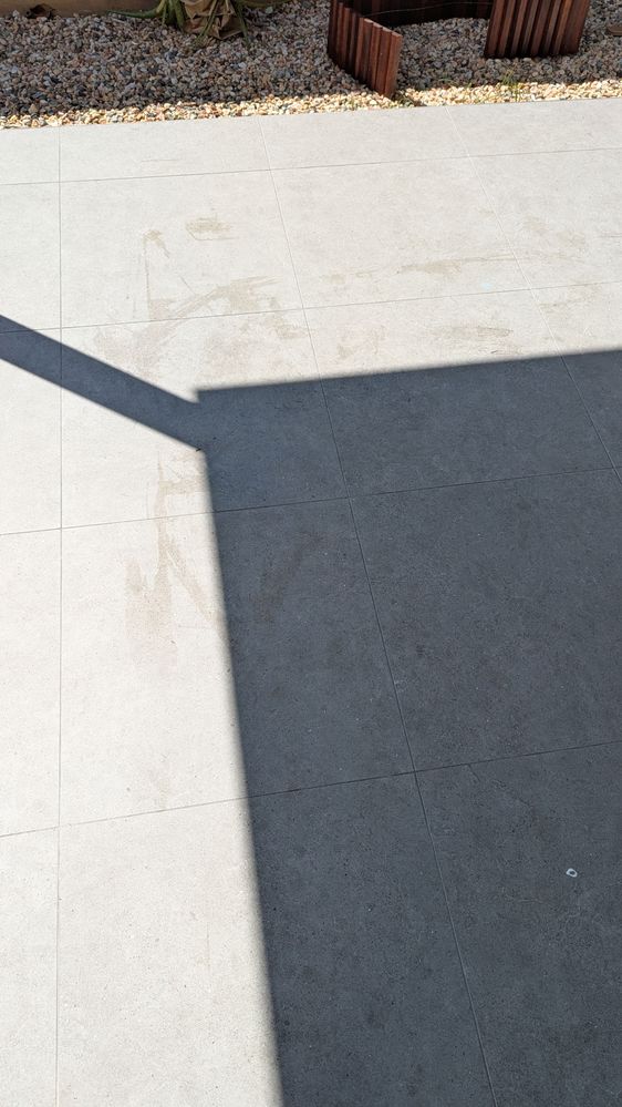

Hello Folks,
I had used Diggers Linseed Timber Oil to coat some wood and had some of that oil smeared on the outdoor tiles. I tried washing it off with tile cleaner and water, but it seems stubborn. Any suggestions on how to get rid of it?
It is a few weeks old now.
Regards
Saif
Re: How to remove timber oil stains from outdoor tiles
Hello @saif
Welcome to the Bunnings Workshop community. It's sensational to have you join us, and thanks for sharing your question about removing oil stains.
I suggest tyring CLR 750ml Oil And Grease Remover. It's formulated to remove oil, grease & tar stains. Your other option is to use Intergrain 1L UltraPrep Tannin And Oil Remover. Make sure to give the CLR time to activate before washing it off. You can then use a power washer to try and lift the rest of the stains off.
Here is a link to our best advice: How do you remove oil stains from concrete.
