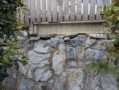

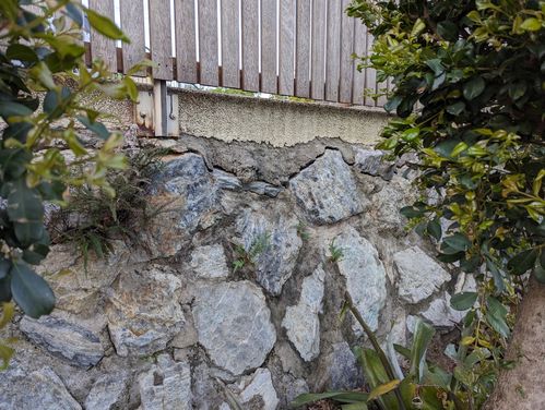

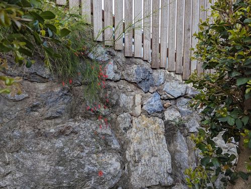

Side retaining wall mortar is eroding. it's a high wall, greater than 1m. The neighbours pool is on the other side of the fence. Does it just look bad and isn't a cause for concern yet or should I get it repaired straight away, and if so how? Many thanks!

Apart from the seperation at the top the stones seem to be still fixed together. (I have cracks that have stayed the same for years around my pool area) However having the pool on the otherside is something to factor in. I'd probarly err on the side of safety and get an engineer in to verify if its structually sound if you are that concerned. It looks like you may be on a steeply sloping block? (looking at the fence line in one of your pics) so I would be reluctant to suggest pulling it down/replacing it without more knowledge of the surrounding ground/rock situation.

I agree with @Dave-1 that it would be best to have the wall assessed by a structural engineer, given the pool weight is being retained by it. That first image is a little bit concerning as it shows the entire retaining wall, or at least the facade stones, have dropped a good 90mm. Once you've got the OK from an engineer it will be a simple job to patch the gap.
