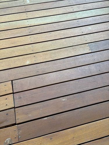

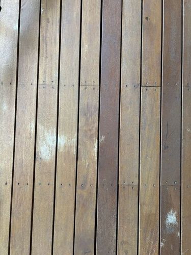

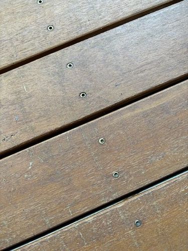

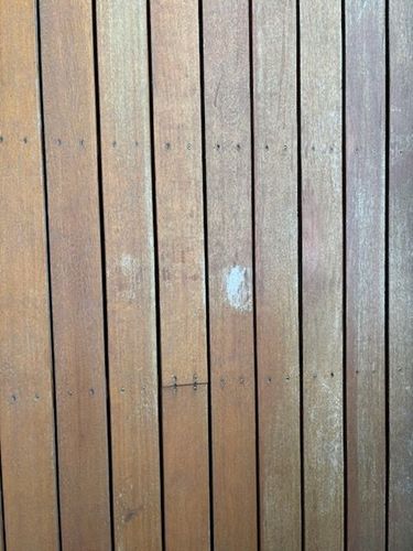

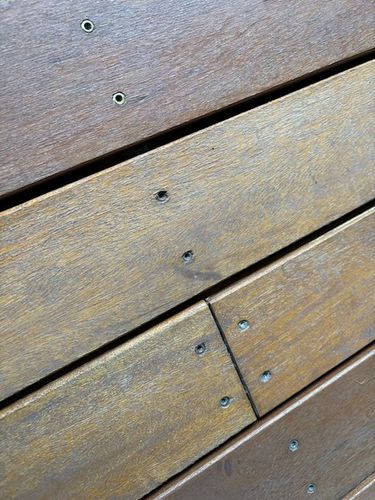

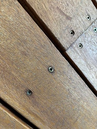

Some photo's of the deck, keen to know if you think sanding is a good option still as well :smile:

I see what you mean about the screws @gamblor. It would be worth sinking the ones flush with the surface down a few millimetres below it if sanding. Your deck doesn't need the timber sanded down, as only the coating has begun to wear through. In order to get a perfect result, you'd need to sand the coating itself off. No need to aggressively sand the timber.
You could try giving it a good scrub down with Cabot's Deck Clean and coating it with at least two coats of a water-based oil like Cabot's Aquadeck. However, the lighter worn areas might still be slightly visible.

Thanks Mitchell - would it be worth doing 120 grit with a floor sander to get it all cleared off?

If you are willing to put the effort in, then using a floor sander with 120 grit sandpaper will certainly be worthwhile. Sanding the timber back to a bare surface will give you a nice uniform finish once the oil has been applied.
An Orbital Floor Sander will make light work of the job if you want to give it a go.
