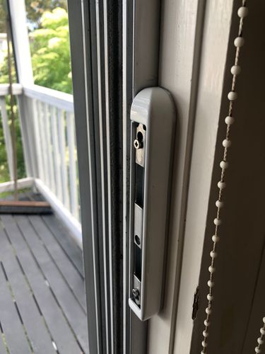

I would like to replace this old door handle on my patio sliding door:
I wanted to install the Lockwood Onyx but it doesn’t seem to fit the existing door frame as one is supposed to mount the strike plate onto the door frame but my door frame looks a bit different:
The strike body slots into the existing gap and is about 8mm thick:

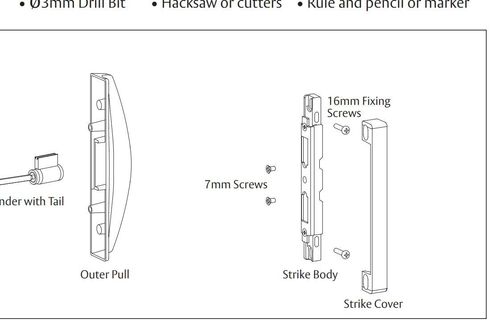

Just had another look at the onyx door handle online and the pdf has the info! but not the width to make sure if it fits into your existing chanel
So i'd be meausuring the chanel width of your existing striker plate and then go to Bunnings and check the width of the Onyx Striker cover

Unfortunately the channel is too narrow for the Onyx striker even without the body.

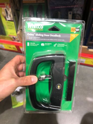

I did see these Whitco ones:
and they seem to have a similar system. But not sure how wide is the receiver bit. I might just try to buy one of them and hope I can make it work ![]()

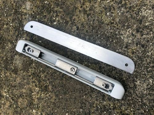

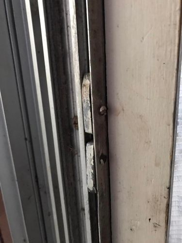

I manufactured a spacer out of 20 x 3mm aluminium bar :
And screwed to the wooden frame:
I think it looks alright. Never mind the chips in the frame and the colour of the door - it’s getting fixed and painted but that’s a project for another day ![]()

That certinaly has come up nice! I really like the "spacer" It looks liek a bought one!
