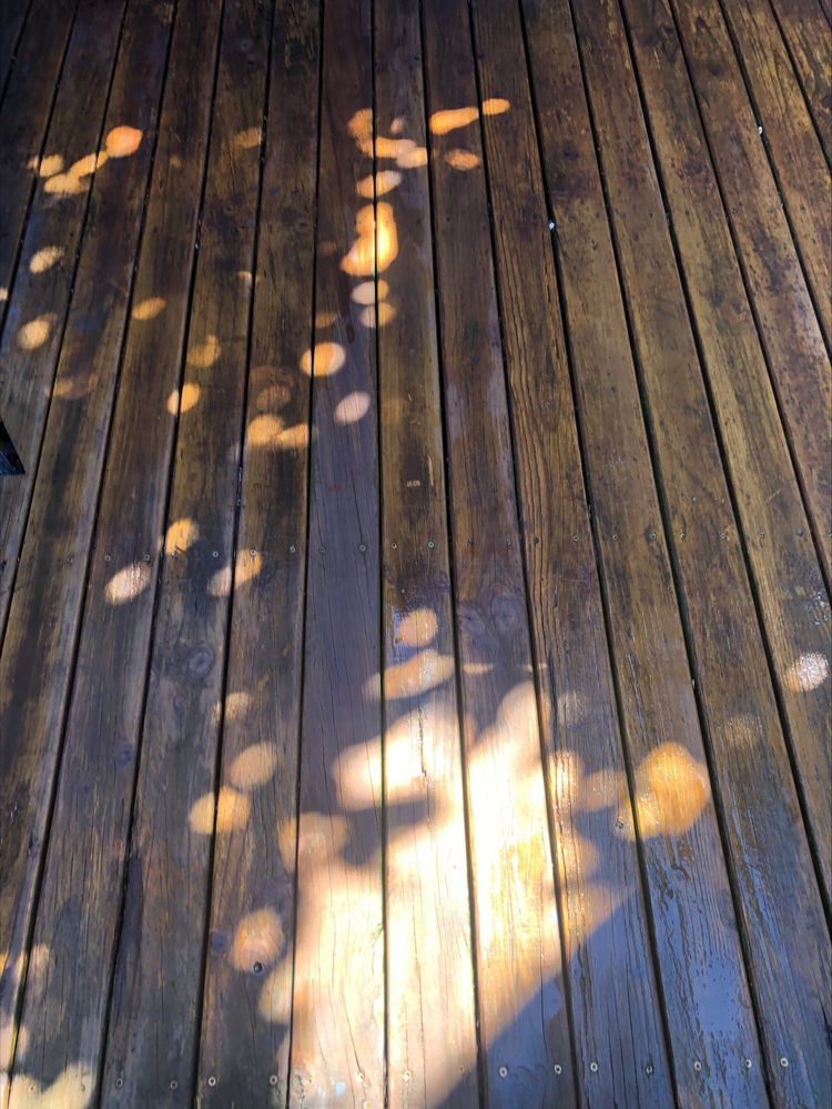

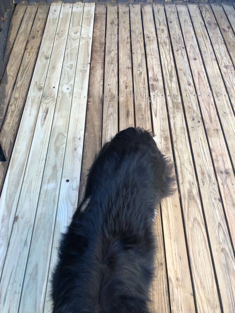

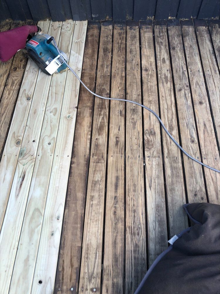

So after getting palings replaced and spending an afternoon with a belt sander with 36 grit, this is what I've got. Another sanding session you reckon? It's hard work and my knees are feeling it. Also what can I use for the edges? I don't see finishing sanders for hire? Will a new jarrah stain cover this?
Any comments or suggestions welcome.
Rosemary
Re: How to restore a deck that has seen better days?
Hi @RosemaryK,
Great work so far! I'd say another sanding session would be needed to remove the rest of that discolouration. Something like this Floor Edger would normally be used around the perimeter. If you flip the belt sander upside down, does the belt come closer to one side of the machine than the other? If so, running the sander on the closer side might get you nearer to the fence. The Jarrah stain will help disguise the paint transition, but I'm unsure if it will cover it completely.
