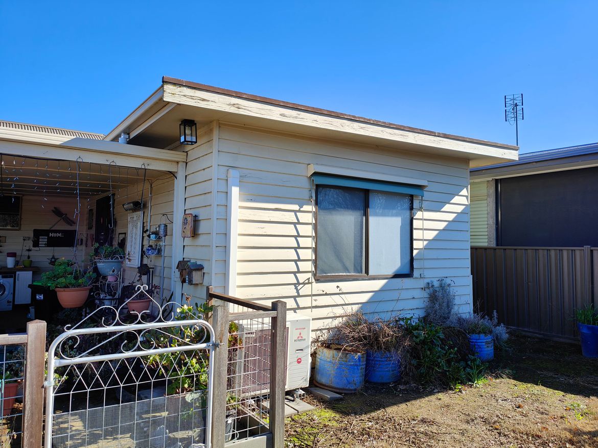

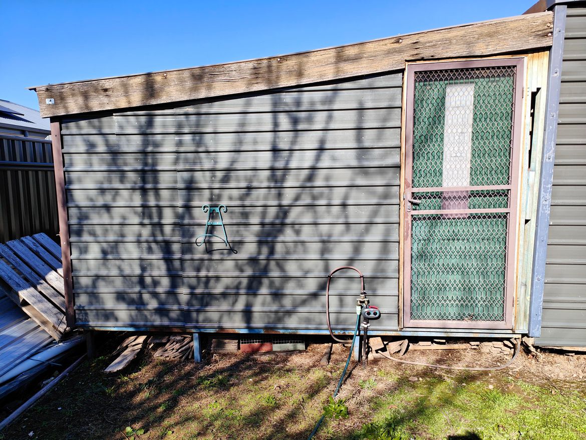

Can anyone give me an idea of how I can attach my straight ladder to side of she or house so it doesn't fall . Not to a gutter of course. I want to be able wear a safety harness. I'm on my own and don't have anyone to hold a ladder. I have some painting to do and flashing to put on a shed.

Scaffolding will be a safer option tho at the height of what you have shown us, a decent 6ft -8ft ladder would aslo be fine. I would suggest moving out all the plant pots either way to create as clean an area as possible to work with.
With the ladder for the painting I would lean it against the sid eof the house. At an angle of around 30 degrees (easiest way is to lean it and stand on the bottom rung, lean back a tiny bit and if the ladder feels like it want to move, then move the foot of the ladder out from the wall a little more)
With the flashing, I would lean the ladder the same way against the middle of the wall. The flashing should sit up over the edge by itself and should be screwed in fromn the side, making sure that the right angle stays that way compared to the roof on the other side (dosnt kick up) I would paint that timber first tho.
