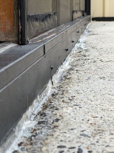

Howdy folks, we just bought this place and we have some problems. Other than cutting out and replacing the silicone that's failed... what options can you suggest? My thoughts were gluing some 1.5mm thick, 150mm wide rubber insert on a 90 degree angle all the way along. I'm worried this will only last with an extremely strong glue. Here's a video of they'll let me add it. https://youtube.com/shorts/xuhPliC0Z_A?si=1O0IvXE-cNJENfUa    Thanks in advance!!

Love the video, by the way, and we're here to help. I know it's tempting to place something on top and try sealing that, but you're creating the same problem again but covering an existing one. I would recommend replacing this current silicone/polyurethane. Cut it all out with a retractable knife and try to remove as much of it as possible. You can then replace it with Sikaflex 11FC in a nice fat bead and smooth it into a cove that transitions from the concrete up onto the face of the door threshold. These silicone scrapers come in handy for creating neat coves. Alternatively, instead of creating the cove, pressing an aluminium angle over the Sikaflex might give you a neater appearance. It would be a similar application as seen in this step-by-step guide: How to waterproof a shed floor
The reason for fixing the current sealant is that anything over the top is a band-aid solution. If the leak continues, you won't know if it has to do with your new repair not working or if other issues are present. By all means, once you repair the existing sealant, you can then install a rubber strip over the top for a double layer of protection.
It appears that the concrete has been eaten away right next to the door, creating a depression where water will sit, and this isn't great. It might be worth pouring some cement in that area to level it out before performing your repair. That way, any water that lands in the area will have a chance to run back away from the door. We have a great range of concrete paints if colour matching the concrete is an issue. Personally, I'd remove the existing sealant, fill the depression with cement, sand the patched area smooth after it's dried, paint the whole concrete area, and then come back and seal the gap between the freshly painted concrete and the door with Sikaflex.
