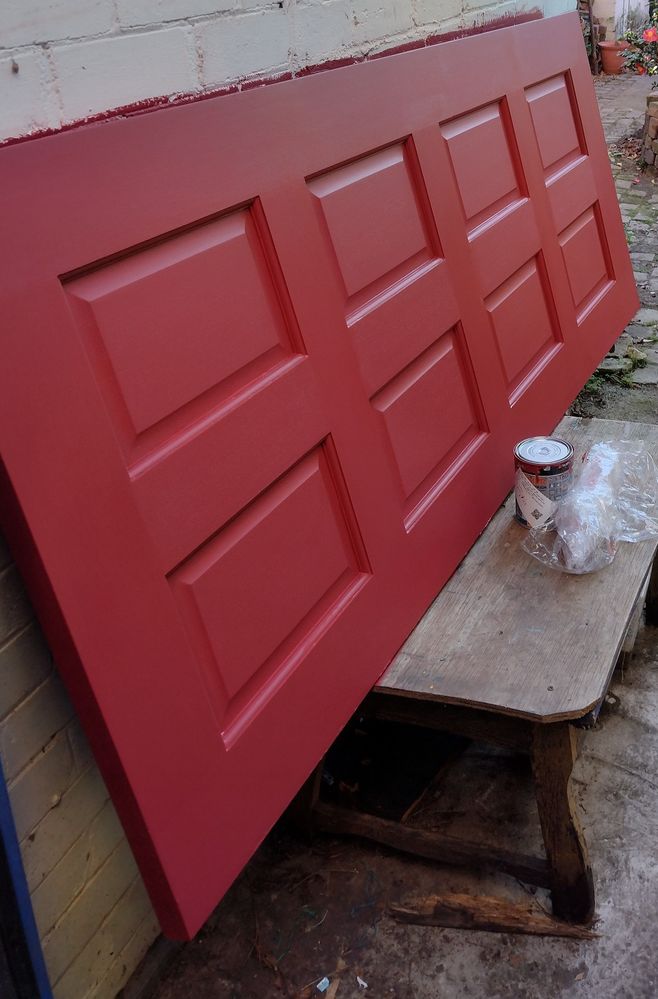

I painted a door with Taubman's AllWeather exterior grade paint, 3 coats matt, as it is for a back gate. The door is hardwood with a veneer. Since we were told not to use acrylic paints on a veneer, I had asked for an oil-based, but now find the brushes washup in water. What can I seal the door with to stop the veneer from lifting?

It does list its qualities on the tin, and the paint itself was good. I'm just concerned about the veneer aspect, and wonder if anyone has had a problem with it lifting.

This is from the website. I didn't buy it from Bunnings, but note that the same door is available at several places.
'Description:
8 Panel Colonial, Solid Engineered maple timber Door. Maple Door can be painted or stained. Do not use water based paint.'
In conversation with the seller I was told that water based paint would lift the veneer eventually.
Regarding the purchase of the paint from Bunnings, the staff member was helpful in finding the paint I needed (matt, dark base ,1 litre, exterior grade) and as the Taubmans was the only one with those requirements he would have thought that it was fine. I should have checked before I left and queried the water washup, but I doubt there would have been an alternative.
