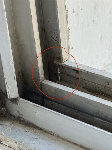

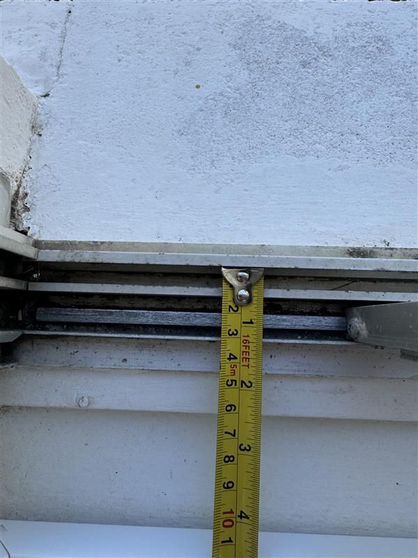

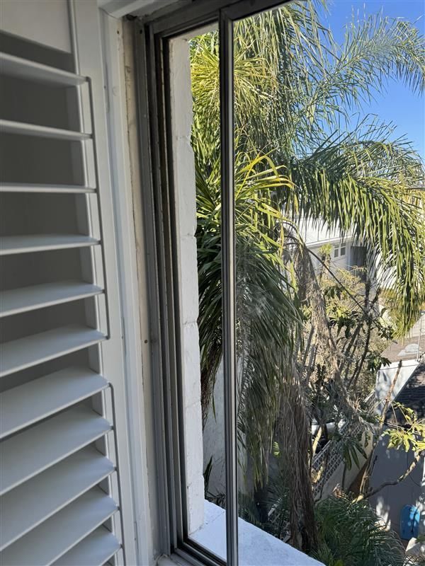

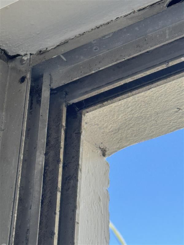

The front of my unit has been refurbed with new glazing and fly screens, but the rear of the building has not been refurbed and has the original windows with no fly screens. As you can see from the photographs there is a slot where potential fly screens can go on the outer portion of the window, however the aluminum joints in the corner are sticking out which would make it difficult for me to install.

The outside channel looks to be 10mm thick and the Pillar 22mm x 2.5m White Flyscreen Frame is 9mm, so you should be able to use this alongside some Rolltrak Aluminium Flyscreen Corner Stakes, flyscreen of your choosing and compatible flyscreen spline to create a flyscreen frame.

Hey Jacob,
So hard to explain, but find attached. I am not sure if this is going to be an issue?

Hi @ChloeS11,
I see what you are saying, but it doesn't look like it should be an issue as long as you have a consistent 10mm gap all the way around that will allow for the frame.
Simply follow the instructions in How do you make a flyscreen frame and you should be able to slot it into place fairly easily.
