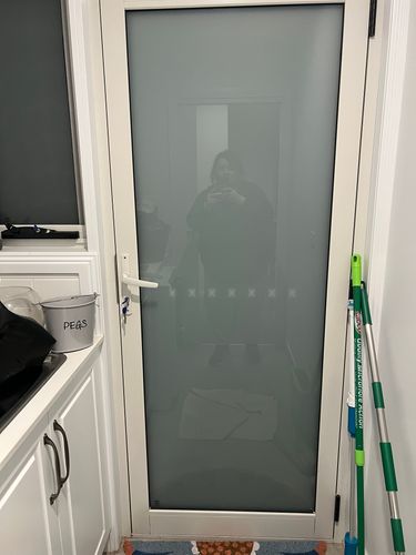

I’ve had a housemate move in with her pup and cat who are the cuuuutest, but I need a doggy door for them pronto 😂
this is my back door, I’m trying to work out the quickest and most affordable way to get this door. I can special order this screen door, will this be easy enough to add to the outside of my existing door like you would a flyscreen door, or would it be best to swap out the door for a wood door that I can cut into and install a doggy door? Wish I had a sliding door somewhere!
any advice appreciated
TIA x

Buy a cheap fly screen door and install a plywood panel at the bottom with the pet door.
You could possibly make you own screen door.
with suitable hinges and install the DIY plywood pet door at the bottom.

Welcome to the Bunnings Workshop community. It's sensational to have you join us, and thanks for sharing your question about your glass door.
I highly suspect that you have a safety glass door, which means that it can't be cut. As an alternative, I propose removing your glass door and replacing it with a Hume 2040 x 820 x 35mm External Door Duracote Flush X1 (it can be ordered custom size at special orders). The glass door can then be wrapped up and put into storage for safe keeping. The standard external door can then be easily cut to take a lockable pet door for the pup and cat. A good example is the Hakuna Pets Medium White Super Tough Pet Door; it comes with a magnetic self centering door and is lockable. It is a much more affordable option rather than having the glass door replaced with a custom cut glass door.

Yeah, doggo and cato need their own little door for surev:)
I hadnt considered the door being safety glass but my thought went straight to storing your existing door and putting in another door that you can cut out a hole in.
I have doggy sat a friends dog in the past and having just a screen doggy door in winter or at night gets a bit cold
Otherwise I would go with that screen door and @AlanM52 's idea as well. Maybe start off with the switchover and also think of summertime down the track and get the screen door then?
Depending on the glass type (safety or non) will determine if a doggy door can be cut in. I suggest Googling "glass doggie door installations" and get a professional company to advise.
