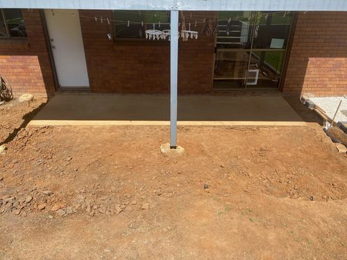

Hi all
I am currently in the process of planning a deck 8050mm x 5400mm but I’m restricted with height (70mm in the concrete slab) and around 100mm at the other end (I have already dug out some soil in this area, so I can have a decent height and I can dig more if needed)
Hoping you can help with a deck design (It's my first ever decking project) as I’m struggling with the specifications regarding the below:
  1. Would 100mm clearance to the ground be enough to use H3 treated pine or do I need to use H4?.
  2. The span between joist and bearers. Would you recommend using a 90 x 45mm or 120 x 45mm or is it better to use a 90 x 35mm or 120 x 35mm considering I only have 70mm height to play with? what span do I need to have?
  3. I’m also thinking about using the tuff block as a foundation system. Thoughts?

I have dug more soil and I have now a clearance of ~220mm.
@MitchellMc can you help with some basic drawings based on the above deck dimensions(8050mm x5400mm)? I understand good practice is to keep about 450mm gap between joists but I'm not sure the bearers and the number of posts I will need.
your assistance would be greatly appreciated!!!
