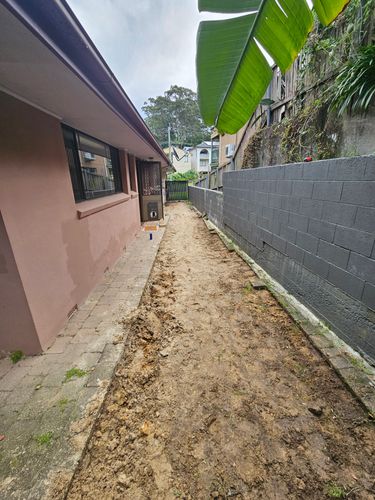

Hi everyone,
I'm redoing the stormwater and drainage around my house due to significant water entering into the subfloor from the high side of my block and making its way through cracks in my brick foundations and into the subfloor.
I'm installing ag pipes 900mm away from the house that are around the high side of the property to catch any water before it hits the house.
Im also regrading around the house as it previously had a negative grade and allowed water to sit around the foundations. Currently I've excavated all the permeable sand mix that pavers sat on and brought it down to expose the subsurface bricks and the top of the concrete foundation. Im then going to fill any cracks in the brickwork, apply liquid rubber and then corflute to protect the liquid rubber from backfill.
Im unsure on what to backfill with.
My thought process is to grade away from the house using a non permeable material, like metal dust, to ensure any water that hits, makes its way towards the ag pipe. Or should I use something like road base that allows more water to flow through. I've been recommended to use gravel or roadbase to use around the foundations but wouldn't this potentially allow water to sit at the foundation due to the ag pipe being 900mm away and not being flush with the foundation.
The final finish will be decorative pebbles to sit on top of the metal dust or road base or any other material that is recommended.
Any advice would be great,
Cheers.

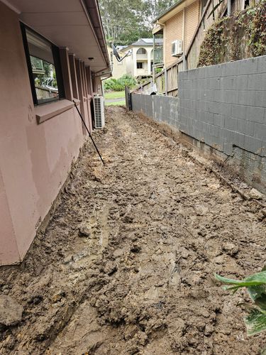

I appreciate the reply mate.
The 900mm distance for the ag pipe is the centre of the blind side of my house. I wanted it to be far enough away to get a proper slope away the house and drain straight into the ag trench.
The only surface water that will reach the house on the blind side is rainwater, so to be fair, there shouldn't be a large amount of surface water that should reach the house.
My house is at the bottom of a mountain and is adjacent to a large creek, so I cop every other houses water, predominately sub surface. Im putting in two 100mm ag pipes side by side with 20mm blue metal filled to the top of the trench to try and allow the water to get away as quick as possible.
The corflute is just a protective sheet to protect the rubber sealer, but yeah I will confirm with a plumber if it's required.
Between the 900mm point and the house, there was sand and pavers. I've excavated and brought the level down to show the foundations and it is also clay. Its currently a boggy mess due to massive rains.
Ive attqched photos of whaf it used to look like, then when i ripped the pavers back and finally how it looks at the moment before it regrade and dig the trench

Hello @trev21
Thanks for sharing those photos of your house and the area you are working on. I noticed one of your photos had paving installed, will you be paving the surface again? This would be an excellent way to redirect any rainwater falling into the area.
