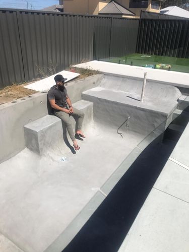

I've just had the internal layout completed (stairs, laying platform, sitting ledge) ready for a tidy up before doing the finishing, all ready for summer as promised 😀

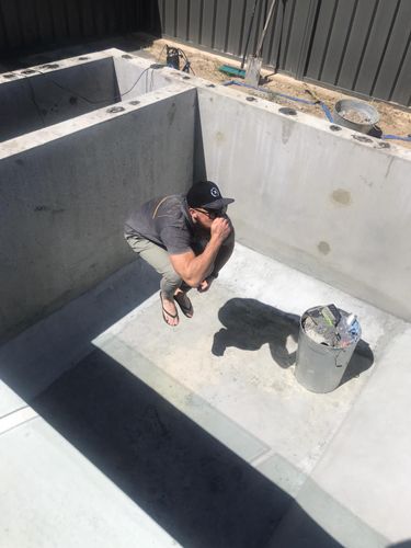

By the way, I'm now offering my professional pool testing services...

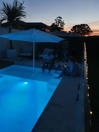

My hard work culminated in an awesome day yesterday spending the morning in the pool with my girls followed by hosting our first party of the season with our closest friends. Felt proud of what I've created for us all to enjoy
Justa few finishing touches required now - ie.cacti feature! And decking lid for underground equipment enclosure
