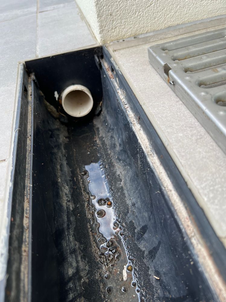

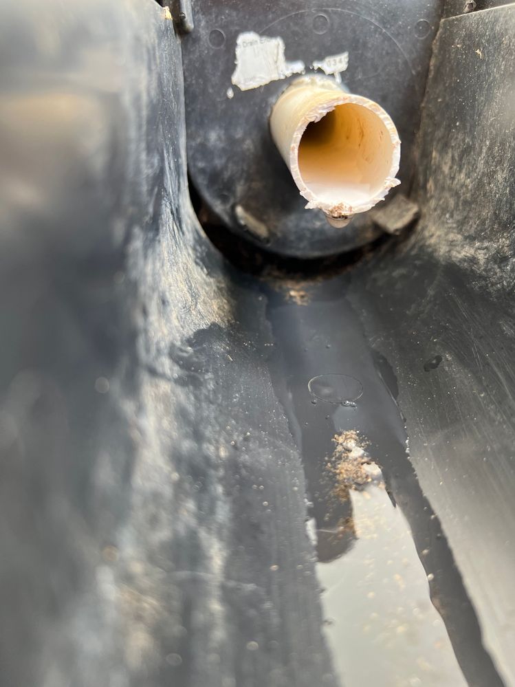

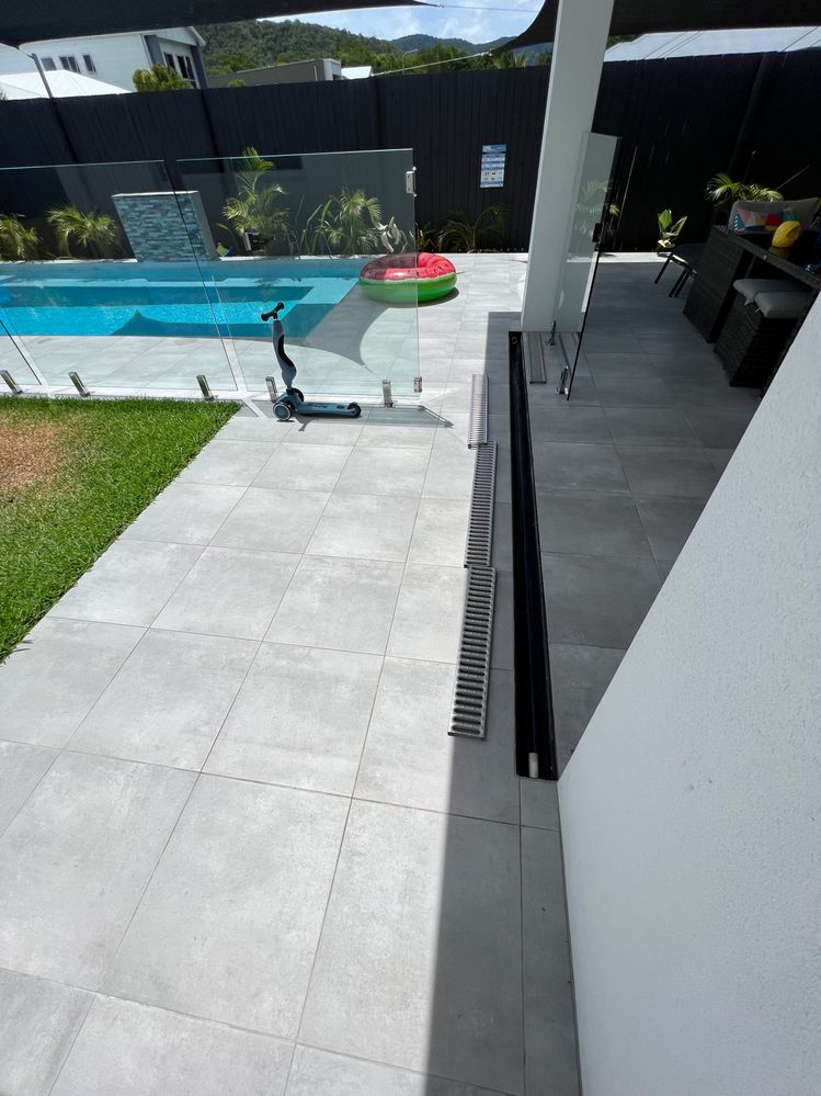

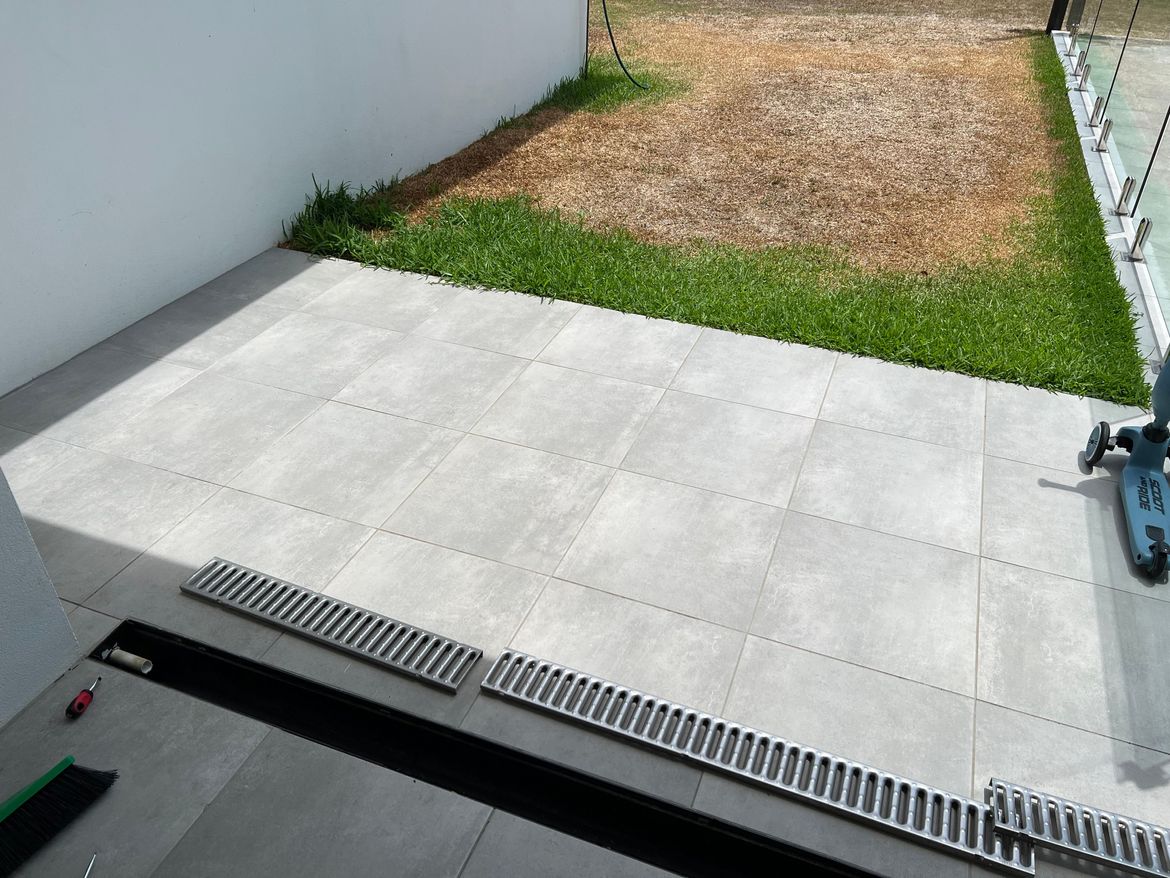

I have a problem with a patio drain and hoping that someone can offer me some ideas on a fix without having to dig up the drain. The channel drain which you can see below collects rain water from the patio and also has a feed into it from the air conditioning unit in the house. At the opposite end the channel drains out to a stormwater pipe. The first problem I am having is that the stormwater drain at the opposite end is a good 20mm higher than the bottom of the drain. So the drain is holding water and once the water level goes above 20mm it drains the excess. The other problem is that the drain at the AC feed end doesn't seem to have been installed correctly and has a gap of 10mm and the water just seeps through under the patio. I can see this is happening as the grass at the edge of the patio is well watered and green compared to the rest of the lawn.

I have included some images below which highlight the problems. Is there a way I could raise up the bottom of the drain channel? Modifying the AC drain and the stormwater drain is not an option as would require lifting tiles and concrete.

Drain view
Image below shows drain from the air con unit in the house.Garden showing possible water under patio
You can see there is a gap between the bottom of the channel drain and end plate. This is where water is seeping out under the patio I suspect.
AC drain pipe, gap at bottom of drain suggests source of leak
This is the storm water drain pipe at the opposite end. what the channel drain should drain into. Its a good 20mm from the bottom of the channel drain so water below this level just sits there.
Drain at opposite end that feeds into stormwater drain pipe.

One way to increase the bottom level of the drain is to put in Dingo 20kg Self-Levelling Cement. I suggest filling it up to the level of the drain pipe. Once you've increased the level, I suggest covering the cement with Crommelin 1L Exterior Grade Brushable Waterproofer. The self-levelling cement will prevent water from forming a pool at the bottom of the drain and guide the water out.
Please remember to cover the drain pipes with a plastic cover and duct tape to prevent the self-levelling cement from going inside. I've drawn up an example of what it might look like once you've filled in the bottom of the drain. Please have a look and tell me what you think.
