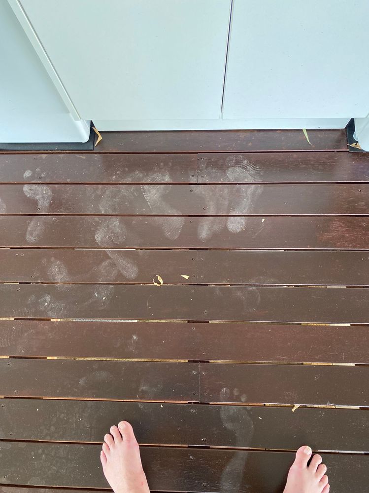

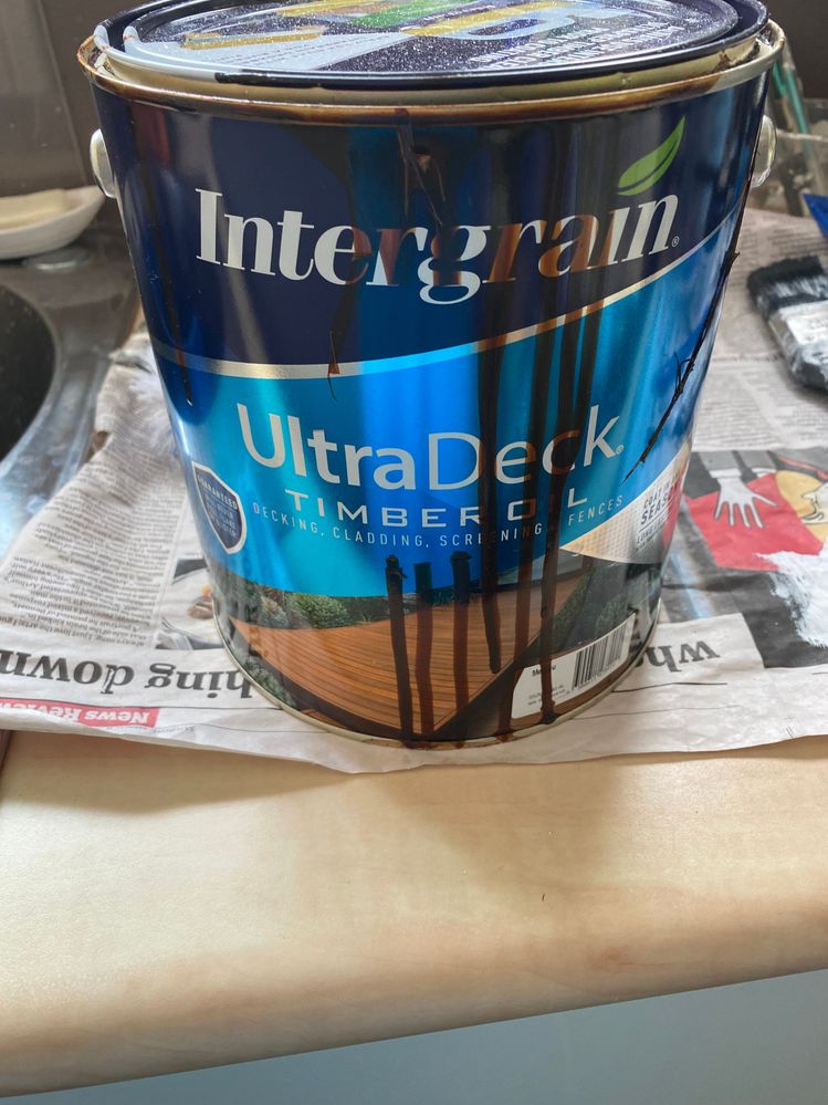

The Deck was stained with Ultra-Deck Timber Oil in Merbau with the final coat going down on Friday 24 March.

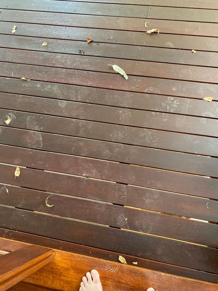

My Client has complained about foot marks being left when she walks on it.
What can I do to fix this please?

Determining whether this is an issue with the product or an environmental factor is important. From the images, a dusty substance appears to be carried onto the deck on the bottom of people's feet and shoes. These white marks are also seen on the door threshold, so the issue appears to not only be with the newly oiled deck.
Do you happen to know whether these marks can be wiped away? If so, that's fantastic, as it means that it's an environmental issue that can be controlled. I'd recommend a door mat to wipe off feet after traversing the dusty exterior surface and regular cleaning as per the manufacturer's guidelines. If these marks are impregnated on the surface and can't be removed, then I can certainly contact the manufacturer to get their thoughts on why this could have occurred.
I'm keen to know more about the issue and assist further. Please let me know if you have any questions.
