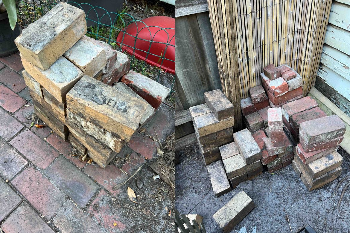

We have a bunch of bricks that are covered with mortar and we'd like to clean them up as much as possible to ensure smooth under bottom for paving and nice (rustic) look for some paving in our yard.
Attached are some of the yellow and red bricks we have to get through..
selection of bricks we have

Wondering if the oscillating blade would be up for the task and whether there are replacement if it gets damaged.

In this situation I think the multi-tool would provide some assistance but the mortar will likely blunt the blades very quickly.
I propose using a combination of blunt force, an abrasive and a chemical cleaner.
I'd look at the Mumme 113mm Brick Bolster used in conjunction with any hammer you've got handy to deal with the bigger chunks. Striking the mortar at an angle should break the mortar leaving the brick in tact.
For the smaller bits and cleanup a combination of a good wire brush, such as Trojan 5x15 Row Brass Wire Brush, and Builders Edge 750ml Cement N Concrete Remover should do the trick.

Hi @alexi
In addition to @JacobZ95 suggestions when the bricks are covered in lumps of mortar, But as your bricks mostly clean to further the cleaning process is simply to rub two bricks together and this will sand 2 bricks at once or rub the bricks on a flat concrete surface is a little easier.
To get that perfect clean use Hydrochloric acid , diluted 2 parts hydrocloric acid to 10 parts water .
Lay the bricks together with the face you want to clean face up soak them with acid water mix using a sfiff bristled plastic broom a couple of times until clean . If you apply acid try leaving it on for 10 mins to soak. do this on other concrete slab and it will get a quick clean too.
Saftey note always add acid to water. Never water to acid to avoid potential eruptions.

To date, I'd been using this biggest chisel which is now admittedly dull and my hands are very sore from repeated paving (I work in IT and my hands are not conditioned for this). The Brick Bolster looks like a machine of a tool which would make light work and might actually help me halve some bricks which I've been fumbling with.
I'm not _too_ keen on going for chemical, but mixed with a wire brush (which I have) and getting MOST of the mortar off will be fine.
Thanks so much for the ingenious idea of a rub together.. Working smarter.. for the small blobs I was just tapping by hand with my chisel set which would get most of it off.. I'm scared of the chemicals, but getting most off is good enough for me.
Now I need to come to understand how to re-sharpen my chisel set. it's notably dull after repeated (and mis-use).

Typically, chisels would be sharpened on a bench grinder. Those masonry chisels are made from very hard steel, so it would be difficult to sharpen them by hand. Just so you know, Craftright is a very budget-friendly brand, and the quality of steel used in them might not be of a premium. You might like to invest in something like a Kango 57mm Masonry Chisel with Hand Protector, which will far exceed the quality of that kit. It also comes with a handy hand guard to help minimise injury from miss-strikes.

I use a cold chisel and hammer and thats about all you need. I wear goves as when you get tired you may "mis-hit" the chisel. A cold chisel is stronger then the ones you have shown, thinkmine was around the $20mark Mumme 200 x 20mm Cold Chisel
No need for chemicals, tho need saftey specs for sure
I was surprised at how easy the mortar came off, tho I do need to practice when chiseling bricks/pavers in half ![]()
Believe me after I had belted my hand and started wearing gloves a brick bolster was on my wishlist
I had a cold chisel and it worked a treat so couldnt justify a new tool was my way of thinking.
