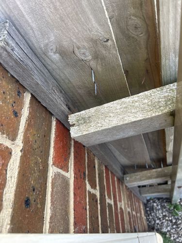

fence leaning due to heavy load on clothes line, best way to fix?

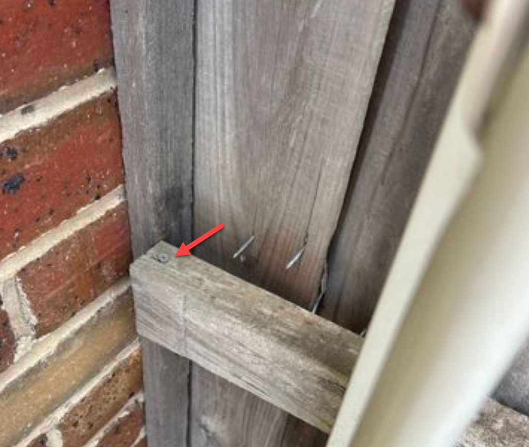

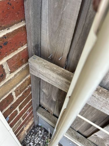

Hi @Co0ki3,
As @AlanM52 mentioned, some photos from further back would certainly help, but you can see that the fence rails were originally screwed at an angle into the post that is attached to the brick wall.
There is evidence of the same situation on each rail, but there is no visible screw like the one above.
Without seeing the whole picture just yet, it seems like the simplest solution would be to reattach the fence rail to that post, then simply tap the palings back into the rail.
You can refix the rail to the post using galvanised screws and galvanised angle brackets.
If the fence rail is only part of the problem and the lean is much more severe, then we will have to see the bigger picture to propose methods of reinforcing the fence.
I'll wait to see what you think and assist further if required.
