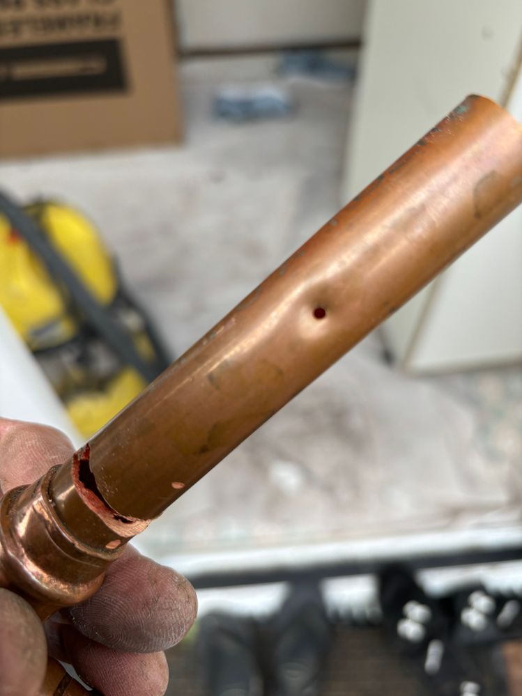

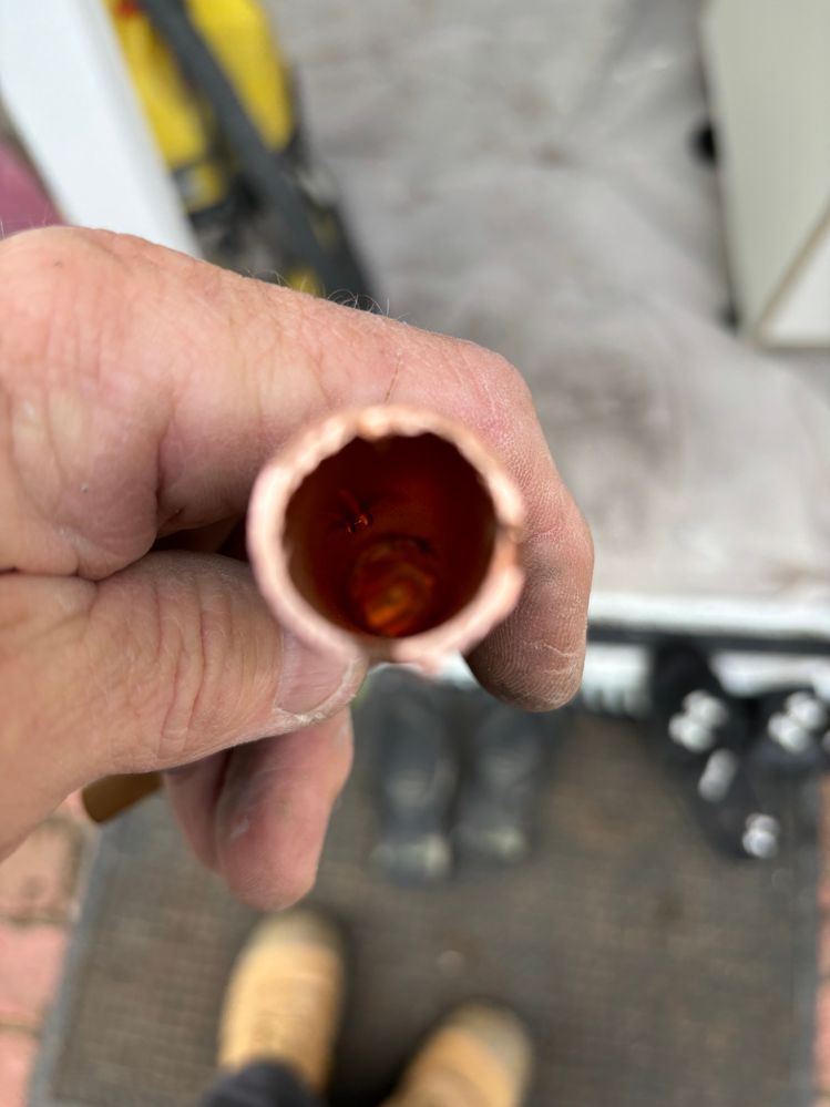

Hi @Nailbag,
It can happen to even the most experienced tradesman.
I always try to take photos with reference to a datum point when I need to close in services. That way I can at least have an idea of where things are when I can no longer see them.
If you don't have access to the inside of the wall to take photos, it's definitely worth checking your building plans to understand where the services are prior to screwing or fixing into walls.
Also ensure you turn off the power, water or gas at their source to prevent unnecessary damage to yourself or your property.
