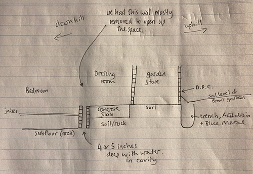

We recently had the wall between a bedroom and its dressing room opened up (our son didnt require 4m of hanging space!!!) - and concerningly, found deepish water inside the cavity wall.
The house is on a slope. The bedroom subfloor (rock) is permanantly wet with little puddles.
The diagram shows all the relevant info - what would you do to solve this?

I would only recommend a sump pump if it becomes impossible to find the location of where the water is coming from. If the water comes in very large torrents during a heavy downpour, then it would be safe to have a sump pump installed in a very large pit under the house. It's not an ideal solution, but it's better than flooding the bottom of the house. I propose looking at the Ozito 500W Vortex Submersible Sump Pump as a possible candidate should you decide to install a sump pit.

I would have and have done similar to you in removing the possibilities of water endtering via your trenches and ag pipe. (Does water flow out of them at all?)
I think that there is a water table from your description, So a question. Does the water level rise or can yous ee water traveling in any direction?
I would also head towards a sump pump, tho not ideal. I would be tempted to chanel the water so the sump pump is outside the building. The floor likes like stone/shale? Mainly because if there is an issue you can see and also replace the pump easily. Any water left under the house will cause issues 😕
