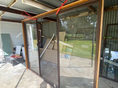

What is the usual finish of an aluminium door, satin or gloss? I’ve just bought the gloss but I’m second guessing myself and thinking of swapping for satin. Picked up a lovely brown sliding door from a salvage yard and will be changing to black.

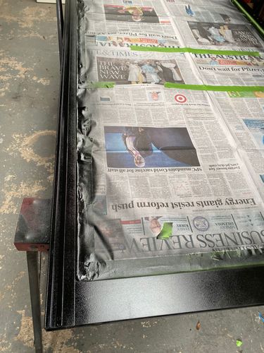

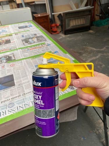

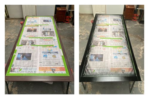

RebeccaR
New Contributor
Re: Painting 80's aluminium doors
Thanks Eric,
I originally bought a gloss spray but swapped them for satin after a few days of deliberations. I’ve done one coat on one side of the removable middle panel and it’s looking amazing so far. I just need to be patient to wait the required time between coats. I’m using Dulux Metalshield epoxy enamel spray cans in satin black.
