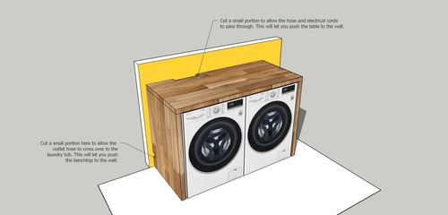

   I finished my project so thought I would share some pictures.I whitewashed the timber then part-sanded it off to give the look I was after. About 3 ...

Hello @Grammy2RD I recommend using a water-based clear varnish on your table on the condition that you used a water-based white wash on the benchtop ...

Thanks Eric,I appreciate the advice :). The pocket hole jig looks interesting. I'll definitely take a look at that, thanks.I will also check out the w ...

Hello @Grammy2RD Thank you for sharing your question about making a waterfall countertop for your washer and dryer. I suggest using a Kreg Pocket Ho ...

I intend to make a waterfall countertop to create some bench space in my laundry and also to protect my new washing machine and dryer. I purchased the ...
