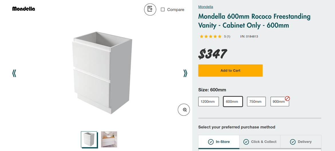

Hi there, I'm wondering if anyone can please tell me if the draws in this cabinet have the cut out space for piping at the back? Thank youScreenshot 2024-07-09 204326.png

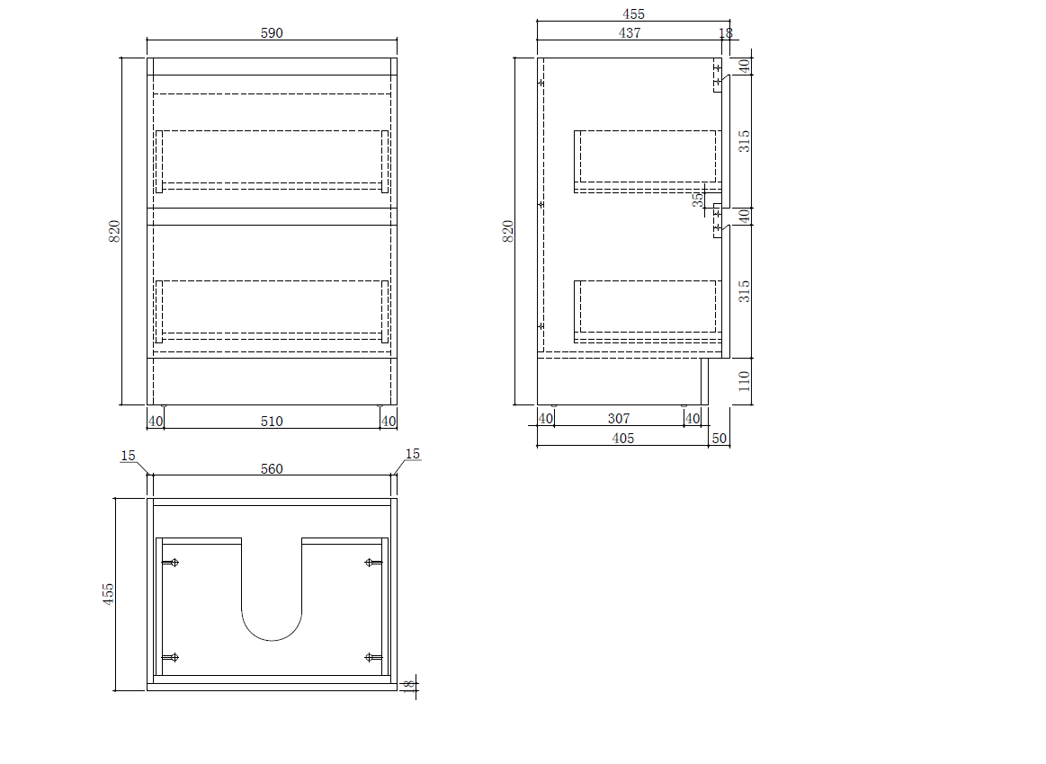

I'm sorry for the delay in my reply @Bubbles50. I've been waiting for the supplier to provide design drawings for the product. I've included them below. There are cutouts in the shelves to accommodate pipework.
