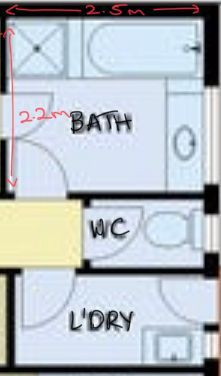

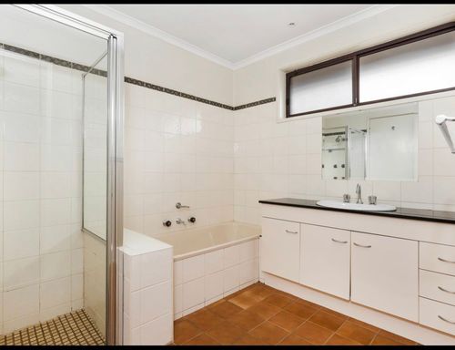

looking to update our bathroom but not sure what the best way forward is.
Ideally want to keep the facilities in the same positions but add in another toilet to the main bathroom. Also was hoping for a free standing tub if we can make it work.
The bathroom is spacious but has two doors which impacts the use of space. All suggestions appreciated!

My apologies for the late reply. Based on your request you actually have enough room to accommodate both a toilet and a free-standing bath. You may have to compromise on the size of the vanity but everything will fit adequately. Here are my suggestions for your bathroom layout:

We can definitely look to shifting the door to a sliding however I am hesitant to close of the mentioned door as it is provides access to the main house, and the other door is connected to the main bedroom.
If we close it off then the only bathroom in the house is an ensuite alone. Perhaps both doors can become sliding doors to reduce the impact of this?
