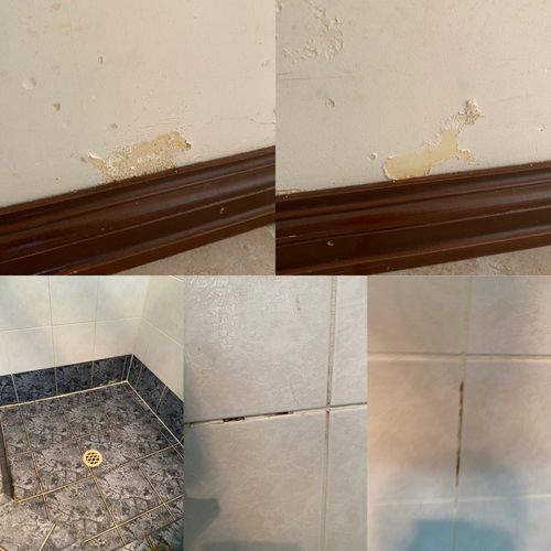

Morning friends. There is moisture coming through the wall from our shower. We recently had two quotes to get it re grouted and they are very expensive. Would it be something my hubby and I could fix ourselves ? If not we will get it done. They checked the pipes in the wall with that special machine to see if they are leaking and they are not so that’s good. Apparently it’s the grout. We would appreciate your advice please 😊

@EricL  are these photos helpful ? There are bits of grout missing on the floor tiles.
Re: How can we regrout our shower?
Hi @mich1972,
My concern here would be that even though there is missing grout, the walls should have a waterproofing membrane that captures this water and sheds it down to the drain. If you are experiencing dampness on the back of the wall, it might indicate there is an issue with the membrane. In order to resolve your missing grout issue, it's a reasonably straightforward job. Cut out the damaged and missing areas with a grout saw until you reach solid grout. You can then fill the areas with grout. Once you have repaired all the areas, I'd recommend going over the tiles and grout with a tile and grout sealer. Here's a guide on How to refresh tile grout and our Best Advice article on How do you repair tile grout?

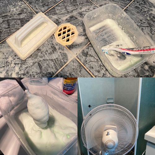

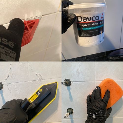

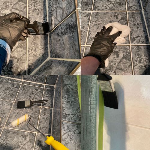

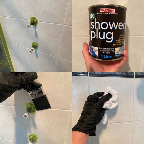

Here’s a few photos of the process so far , everything purchased from Bunnings 😊

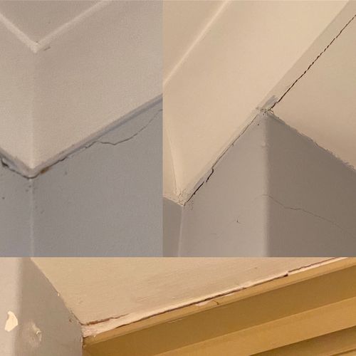

Also there are a few cracks in the walls due to movement over the years from what my hubby said. From what we know the house was built in 1994. We are the second owners. There are a lot of cracks like this throughout the house , I want to concentrate on the bathroom first.
