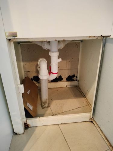

Hey! Trying to remove  our old laundry sink and replace with a storage cupboard. Is it possible to cut the grey pipe shorter and put the washing machine hose in there and seal it somehow? Thanks for the help!

It will be necessary to have a trap to prevent sewer smells travelling back into your washing machine. It's also possible to move the trap so that it is out of the way. Since this involves plumbing work, it will be necessary to engage the services of a registered plumber. The plumber should be able to find a way to lower the trap and still be able to install the washing machine waste pipe.
I suggest purchasing your cabinet ahead of time and assembling it. This will allow the plumber to make critical measurements that will let them cut at the precise location.
